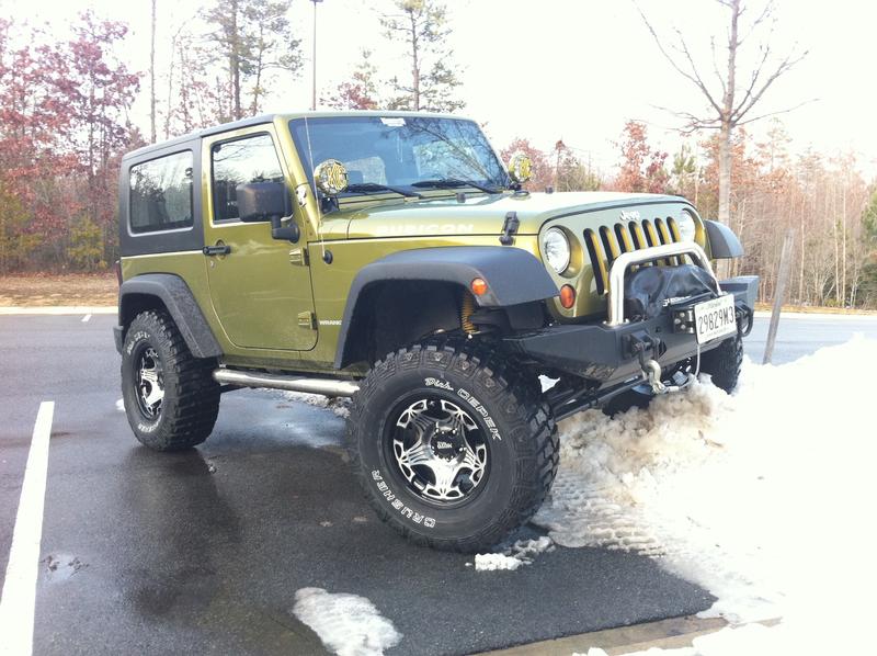

i have 35" x 12.5 tires on 17 x 9 Back Spacing: 4.53 rim it sticks out a tad but only like 1" or 2" and it looks way better sticking out a little if you can get away with it i would recommend it
