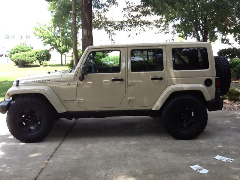

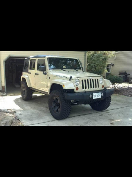

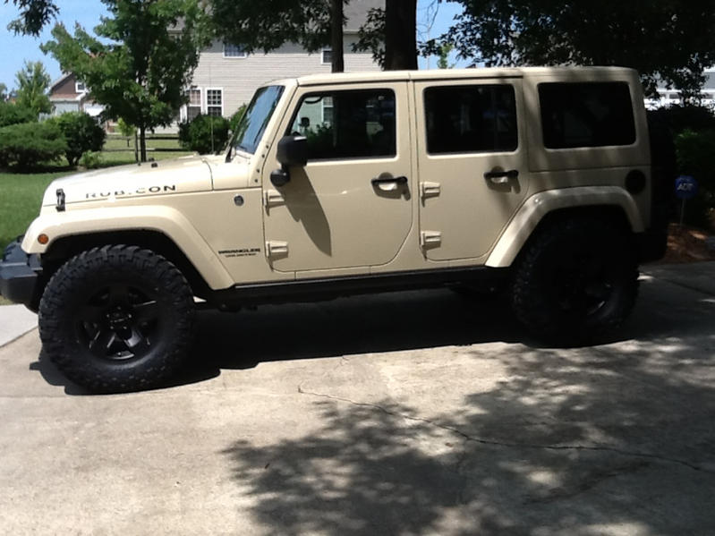

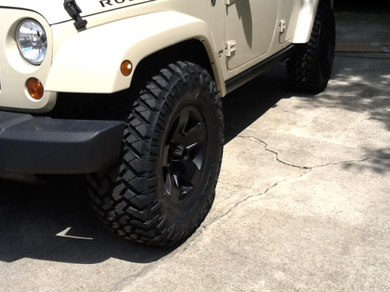

Here are some things I have found with mounting 35's with no lift. I ordered the Method Racing Fat 5 17" with 4.7 BS. 35" Nitto Trail Grapplers and a few other goodies to start. I was too excite to put on the wheels so I have yet to install my lift (Back ordered). Here are my findings and thoughts.

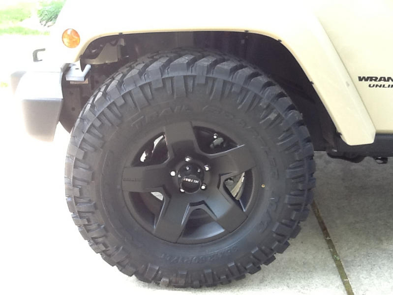

1. The Tires will rub the front spoiler and Rear section of the Rubicon Rock Rails. I trimmed the front Spoiler on the lower corners and the rear rock rails about 1/2". The Passenger side is back about 1/8" (factory mount holes off). This will be corrected with the install of the M.O.R.E. steps. They will rub the fenders with 3 or more people or a heavy cargo load and mild dips/bumps. For street use, they're ok. Moderate flex of the suspension will rub.
2. The tires only rub the fenders with heavy flex. When I drive alone, there is no issues on the road. With another adult and 7yo child, I get rubbing on heavy dips/bumps.

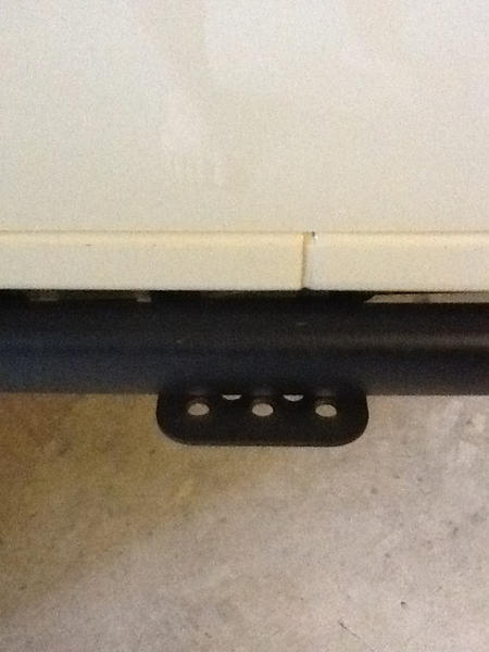

3. M.O.R.E. side steps. These are nice. Can be seen however are not as obvious as tubular side steps and can be removed easily. They retract via spring load and my daughter loves them. The fronts are direct bolt on. The rears will require a hole to be drilled in the pinch seam and the floor board. I am also using a 1" aluminum tubing for the rear bolt mount just to reinforce the step. I originally spray painted which is already chipping. I removed the steps since I had to trim the rock rails and now having the steps powder coated to match the rock rail.
4. The lift. I originally chose the Old Man Emu kit. I am a fan of OME as I had their goodies on my Land Rover. I liked everything about the kit except it required cutting the lower control arm months on the axles. If you are off by as. Little as 2mm, you're done. Alignment correction would be a challenge after that. I returned the kit and ordered a 3" Full Traction Ultimate Kit which is currently on back order. Thus why I am running 35's now with no lift.

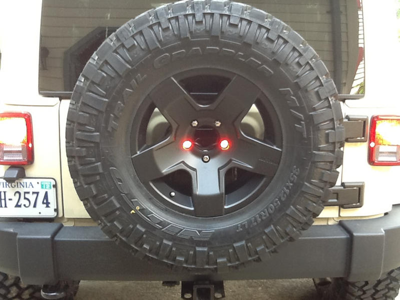

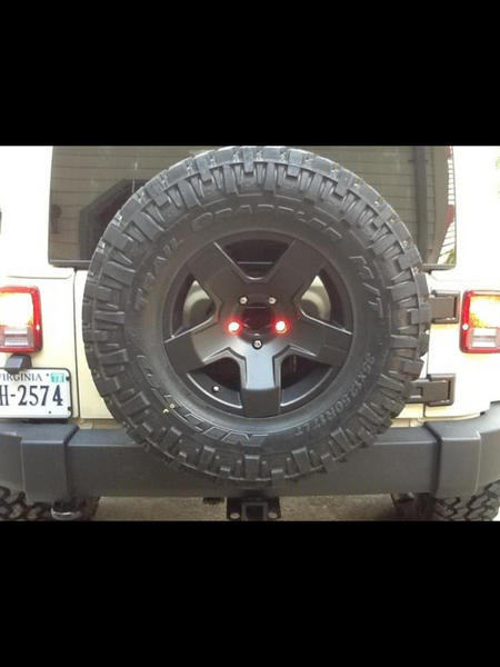

6. Spare tire carrier and 3rd light. I used the rugged ridge spare tire carrier. Simple, clean and good fit and finish. I also used the Delta 3rd brake light kit which looks pretty good as well.

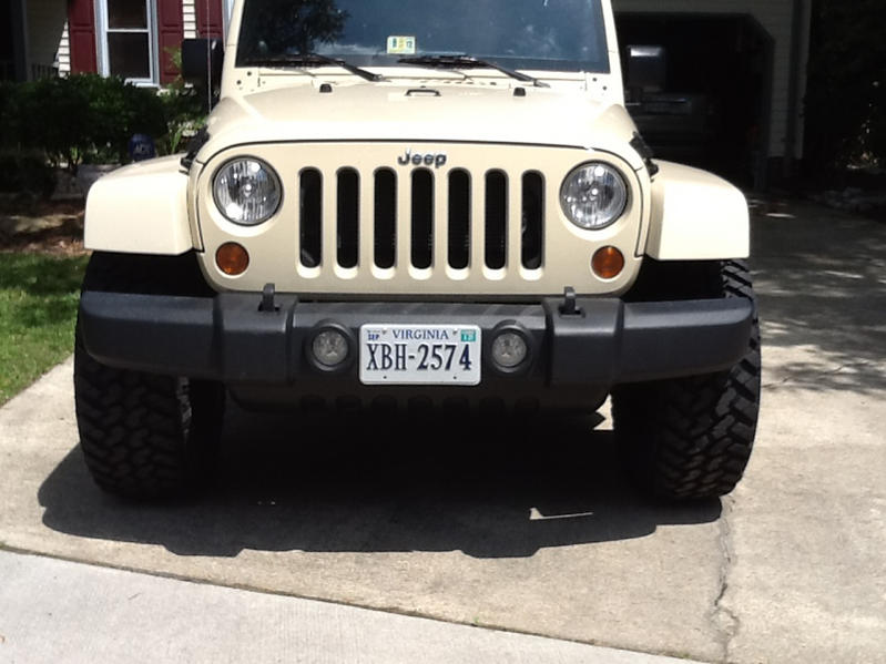

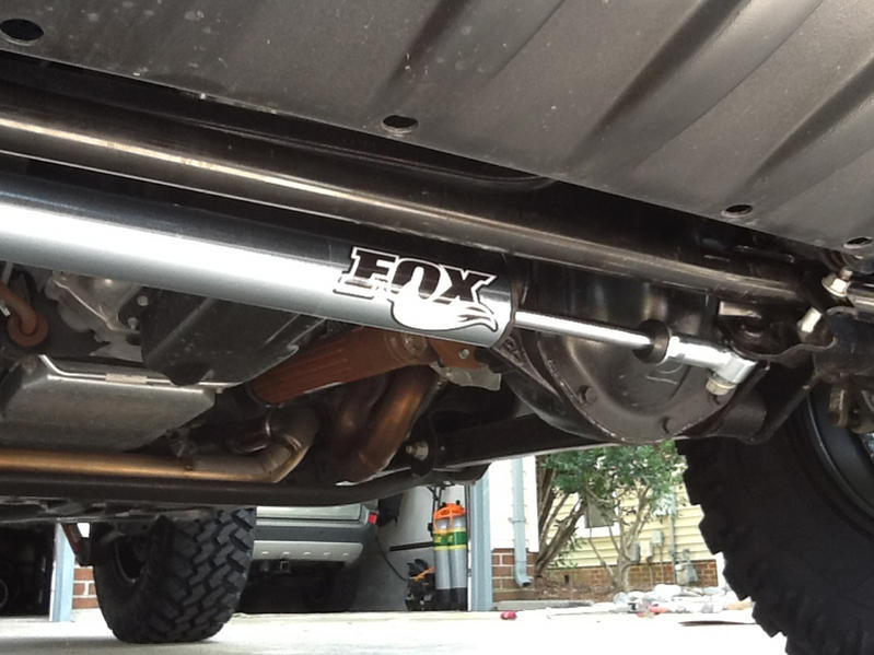

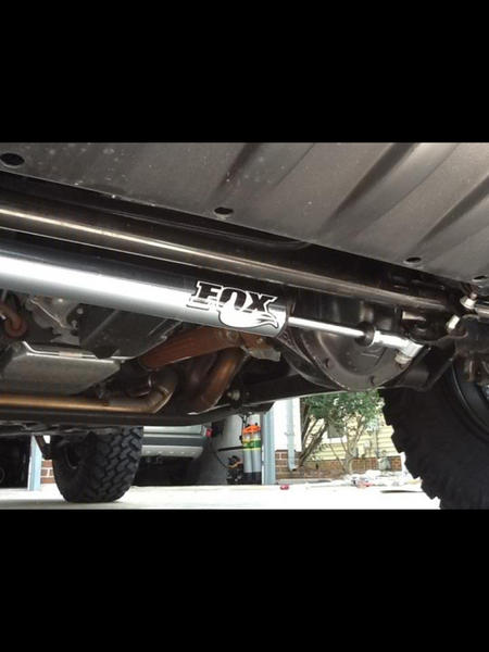

8. Fox steering stabilizer. This is a nice, much heavier duty than stock unit and controls well. Figment needed to be modified a bit. The bushings needed to be trimmed at the axle end. You will also need to measure and split the difference for proper positioning as well as reposition the tie rod mount for diff clearance. Once on, it is good. I think you can see the repositioning in the pic.

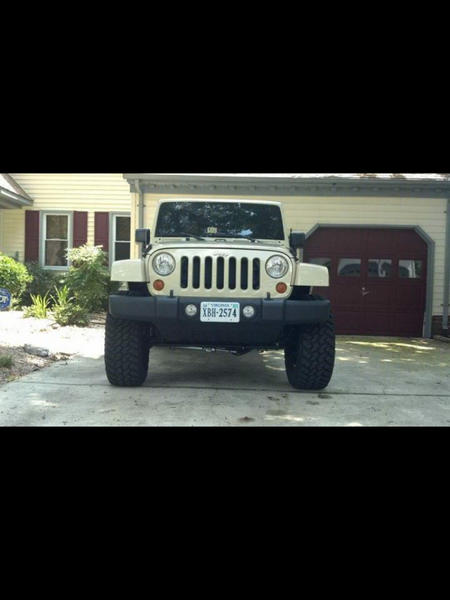

Updated with the full traction lift. Check my profile to see he full details. I posted new threads.
