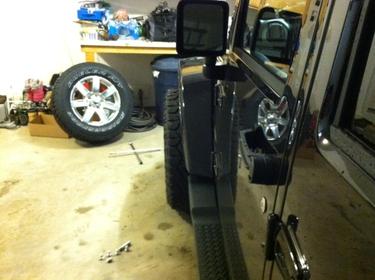

I don't think it will end up working. I made a rough set of 2" spacers just to mock the wheels up. With 3" back spacing, the tires are about 3.5" outside the stock flares

Not sure...fabbed up set of 2" spacers (found a few conversion adapters that were 2" thick to convert from the chevy 6 lug pattern to the new 5 lug pattern? then placed the wheels up to the spacer and measured. The tires (275 65 20's - 34*11.50's) stuck out past the flare 3.5-4". This was done sitting level on the ground. The temp spacers will not permit me to bolt the wheels to them and turn the wheel or flex. What size are your tires? I see 31's but what width?

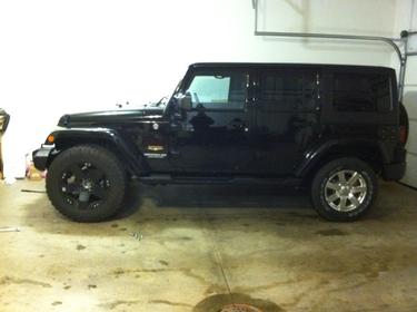

I broke down and bought a set of the adapter spacers to give these a try. The wheels/tires stick out about like yours. I would definitely need at least a 2" spacer lift.
Let me know what you think...Click image for larger version
