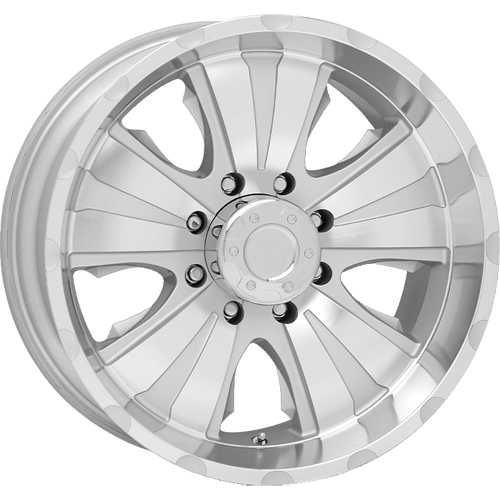

But anyway, I currently have 315/70R17 Hankook Dynapro RT03's on my chevy with a set of American Racing Dominator wheels...see attached. My question is:
I am pretty sure they are a 17X9 with a -12 offset, 4.5" backspacing and are running a 6X5.5 bolt pattern. I know I can get converters for the bolt pattern, how is the offset and backspacing going to effect things. The converts exted about 1.75" as well. thanks in advance guys.

IMO 4.5" backspace with 1.75" spacers are gonna stick out pretty far, at least for the stock flares. If you go with a larger flare like the bushwacker flares it would probably be perfect.
What about selling the wheels off and getting some JK specific wheels to use with those tires?

I thought of that as well...but selling anything around here is like donating it to good will...you pretty much have to give it away! What is the back spacing on the stock wheels?
I have 1.5" spidy trax on there now with 11.5" wide wheels and they aren't that bad. Just a little bit outside the flares!
