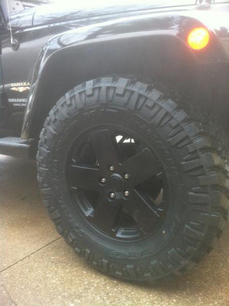

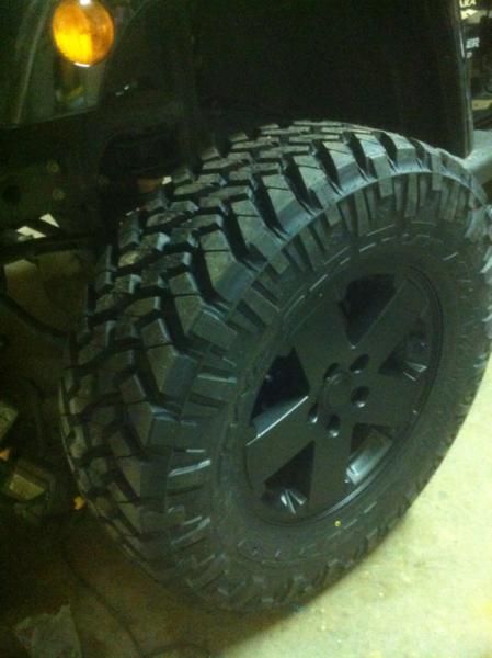

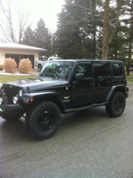

Get the tires you want, get some scuff pads, clean them, getself etch primer ( be sure sand and clean 2 coats-oh so smooth, and spray on some canned bed liner 4 coats. I dig the stock rims and dig them even more black! It's all in the prep work so take your time and the liner will stick like glue!!!!!
