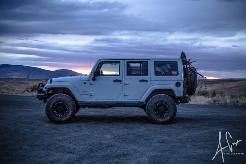

I'm running 35" Grabbers with a set of 17" pro comps 7033-7905's. damn near all pro comp wheels will work that I've seen. We lift about 4 JK's a month at work and haven't had one not fit. Here's a pic of mine on GG's

I'm running that size General Grabber Red Letters. I run them on AEV Savegre wheels. I have not had any figment issues. I am running the standard backspace listed on the AEV site for the wheels. I like the look, but the wheels are awful soft. Mine are pretty skinned up. Not sure I would go with them again. Good luck.
Just noticed I posted a pic with my old tires. Can't figure out how to delete just a pic.
