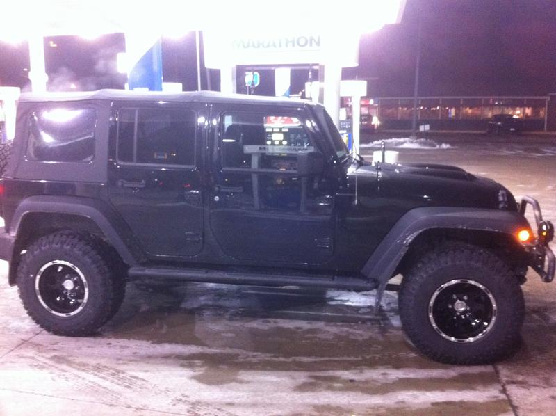

I just put on 16 X 10 procomps with 4.5" BS with 33" DuraTracs. Went on no problem. Mounting up 15's seems to be on a case by case basis.
Name:	lift and tires on!.jpg
