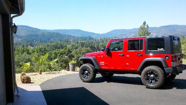

My 4.88s were $1000.00 out the door. Here is my jeep with 33s and the Tf 2.5" coil lift with an added 1" spacer up front to level it out.
