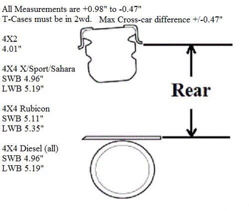

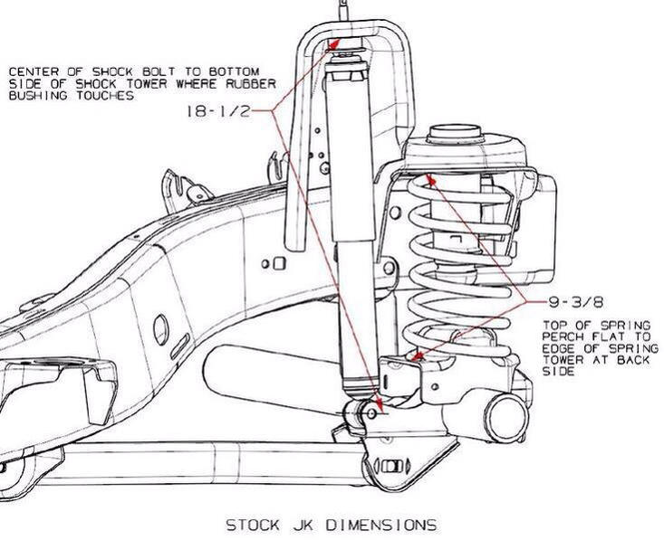

Where is best place to measure how much lift you have? Top of axle to frame, if so can someone chime in with stock measurements for stock jeep! Maybe, top of axle to upper coil perch?
Old Apr 9, 2015 | 03:48 PM
JE8154's Avatar
Posts: 2,256
From: Madison, New Jersey

Thanks, just what I was looking for!
