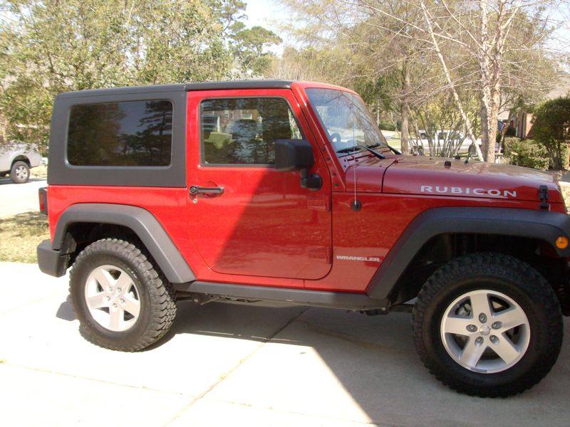

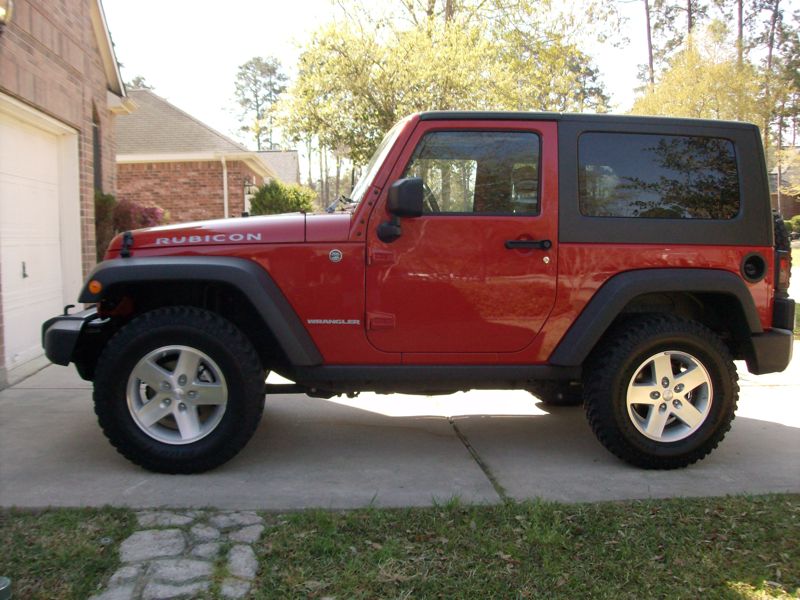

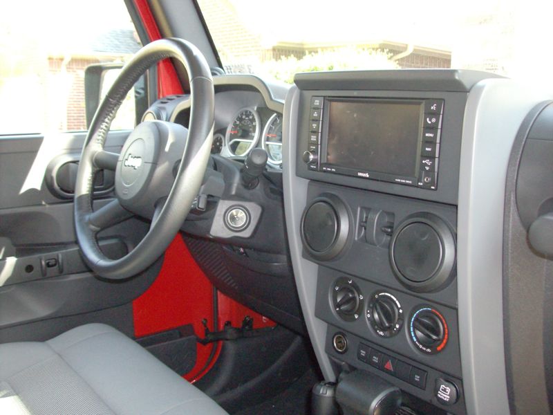

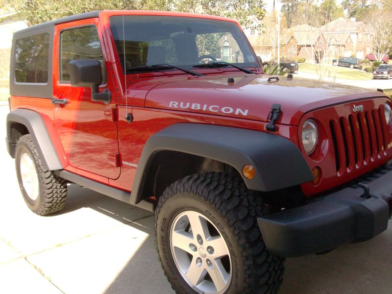

I just got my first Jeep a few days ago. '09 Rubicon 2 door, Flame Red, Hard top, Automatic Tranny, touchscreen radio/nav.
I have a few ideas of what I want to do with it (mainly from reading this forum!). But I'm kind of overwhelmed. I am an avid bowhunter and will be pulling a 5x8 utility trailer on 400 mile roundtrips several times a year. The areas I drive through in central/west Texas are loaded with deer and deer/auto accidents are common (I hit two last year in my F250).
So I'm thinking a good front bumper should be high on my list. We don't get a lot of mud, but I do go through some pretty rocky terrain on my hunting property. I'm thinking of a 4" lift with 35" tires.
I also need a hitch receiver basket for hauling ice chests, deer, etc. in the areas where I can't pull a trailer. Anyone know of a good brand/model?
If anyone can give me some opinions on how you would prioritize your upgrades/mods, I would appreciate it. I know these are some open-ended questions....but any info would help.
Thanks!

Congrats on the new Jeep, and welcome to the forum!
I'm thinkin' you might want a full-width front bumper for better protection. When I was shopping for my front bumper, I spent a little time considering a full-width one, and I really liked the Rock Hard one.

damn nice rubi

On the front bumper, and with the deer issue, run with a mid or full width bumper to give you some wheel and front axle protection. A stubby would give you better approach angles, but that's not going to matter if you can't roll your rig to where the rocks are.
