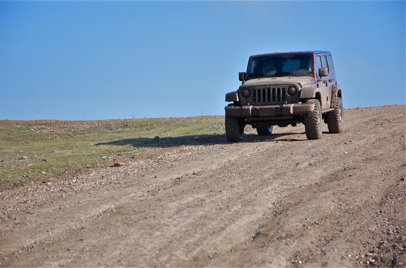

TF 2.5 coil is a great package. In time it may settle, but not by much if any. Kind of muddy but the wheels do not go past the fenders. 275x75x18 Cooper STT w/Spiders
If memory serves, TF states minimum of 4.5 backspace so the wheels will not rub the suspension at articulation. I think the rear. With 35s the wheels could rub the inner flares at full drop. I too was leery of spacers at first, but if you install those Spiders correctly, I wouldn't be concerned. Ran this setup for 3.5 years and 80,000 or so miles. Not only will your rig feel more stable on turns, but you will get a very nice stance.
