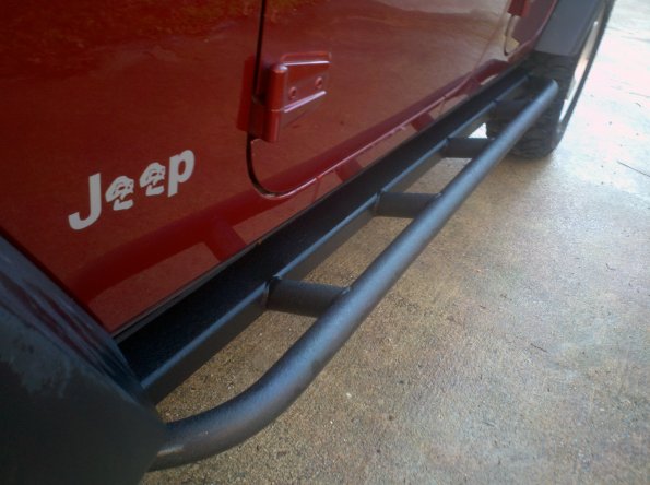

ID:	133579Sorry for the delay, I did get these and put them and they are stout! I also ordered the pich seam cover, which adds a really nice touch.
He will ship them bare metal for powder coat for an extra $100...I went bare metal and took them to a truck bed liner place near my home to get them sprayed with a product similar to Line-X. The guy there said he would touch them up no problem if I rub it off on the rocks. As to the shipping and packaging, no issues there...he packs these tight and snug...even kicked in a few stickers! Click image for larger version

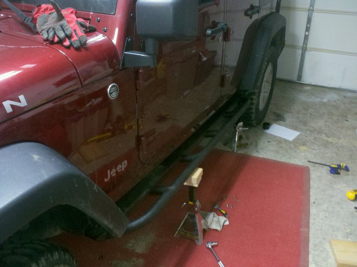

The installation was pretty straight forward. They attach up front under the first bolt where the skid plate attaches to the frame. Once you get that one threaded through, we used jack stands to hold them in place and scratched all areas with dental tools...drilled the holes and bolted them. That first hole, I think is what makes it so easy...once that is set, you know where the rest of them line up.

As you can, hopefully, tell from the pic Click image for larger version
ID:	133582 they stick out further than what some may expect, but that is why I ordered them...they are also nice steps! My JK is already hard enough for my wife and kids to get into and when the stock tires die, the lift and wheels will increase in size!
