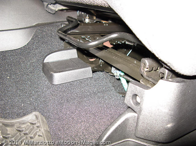

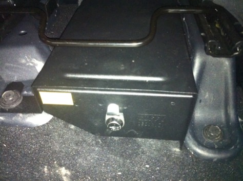

Originally Posted by scottz
DO you have a 2011 2 door? Because I KNOW it has been installed in some.
I do. I really wish it fit b/c i would have a tuffy under my seat right now. But the frames are very very different for the 2dr front seats compared to the 4 door front seats. It is not physically possible. Take a look at the pictures. The bar is in the way on our seats.

Thank you. Looks like a trip back to 4WD at lunch tomorrow.
