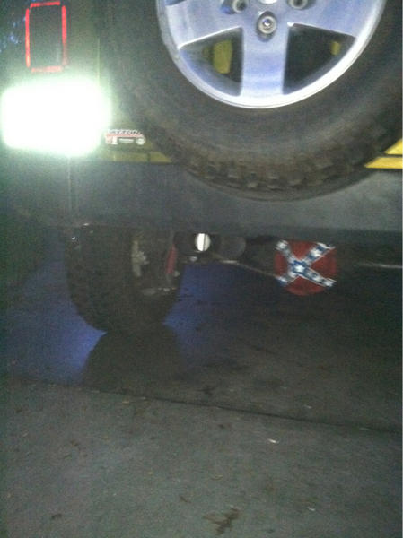

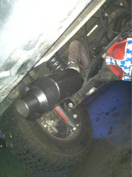

green pup79's Avatar
Posts: 121
From: Tarpon Springs, Florida
All I did was got a flow master 10 series, and welded on some pipe and a hanger, and clamped it to the stock position. It's pretty much as high as you're going to get it.
