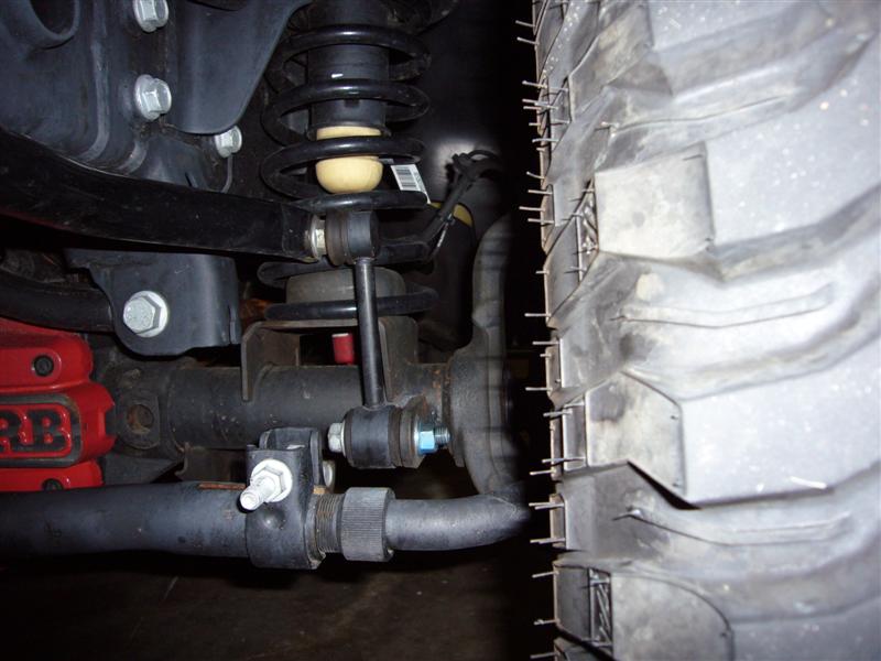

I was in the middle of tax season and had little time to do stuff myself, so I took my Jeep to a local guy I know very well (at least I thought I did!) to install 3/4" spacers in the front.
The Jeep looked great when I saw i from afar and I took it home since it was late and dark when I picked it up. I got home, got a flashlight and looked underneath and saw this!
Name:	Passenger - Before.JPG

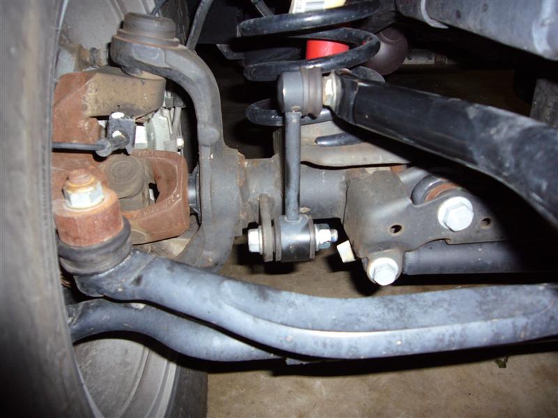

The driver's side was fine.
Name:	Driver - Before.JPG
Since I didn't have a 12mm - 1.50 pitch nut in my arsenal of hardware, I had to wait for the next day and go to my local Ace hardware and purchased 2 new nuts and washers and averted a crisis. I immediately went to the local guy the next day and showed them the pics - they refunded my money ($75), but lost any future business and any referrals.
I don't think the top bushing is damaged, but we'll see how it holds up. It's been fine so far and it's been about a month and a wheeling trip to URE.

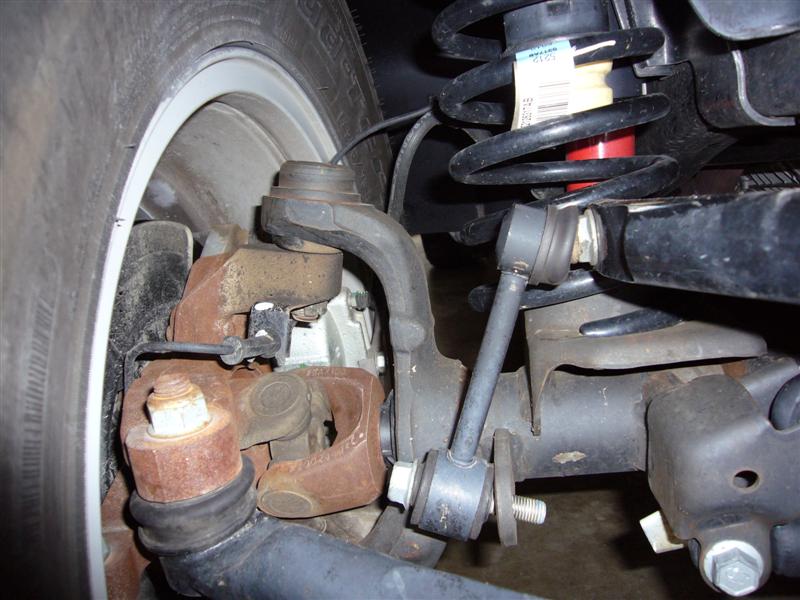

For those of you that noticed, yes, I used blue lock tite on the new nuts since I won't be taking them off due to the elec. disco.
Name:	Passenger - After.JPG
I also changed the nut on the driver's side to be safe.

I hope you went back to your "buddy's" shop and put your foot up his A$$. That could have caused some serious damage, and not just to your rig.

I see them and all I can say is wow, just wow.

Sorry to see that happen to you. That is just bull and total lack of attention to detail... Ya know, like putting a nut back on that holds one whole side of your front suspension!!

I have actually done this myself. I have extended front sway links and made this same mistake, but it didn't look so bad because they are longer. I doubt your bushings were affected, but I'm really surprised he didn't even bother to install the nut. Can't blame you a bit for your reaction; I'd do the same if I paid to have it done and was delivered as shown.
