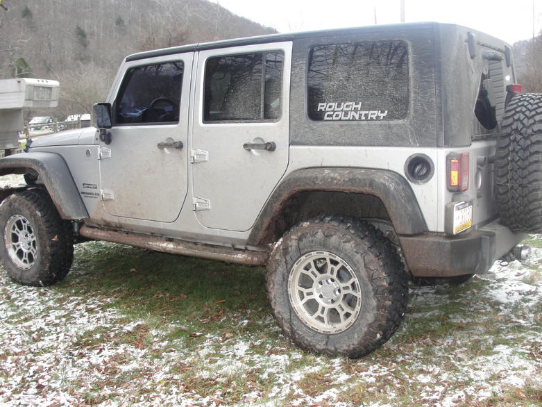

Old Jan 14, 2011 | 12:23 PM
sum-daze's Avatar
Posts: 63
From: Prospect Park, PA
I am running 17X9 VTEC RAPTOR wheels with 4.75 of back space and LT285/70R17 HANKOOK DYNAPRO MT tires. They may stick out an 1" thats all. this is the best pic I have so you can see what they look like.
