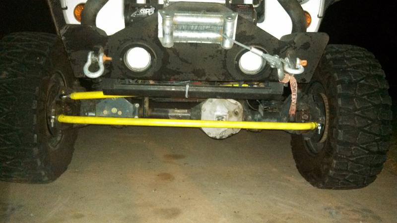

I have the rk 3.5 coils but not sure what a steering stabalizer is?
