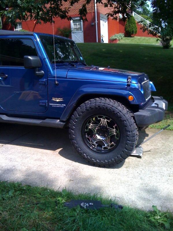

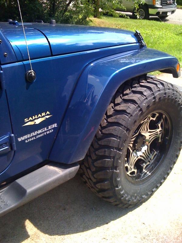

Just got my tires mounted on my wheels today. I don't have my lift yet, but I couldn't resist seeing what it was going to look like. I have a 5" trailmaster lift on order, posed to be here monday. I only jacked up the axle, because my jack wouldn't reach the frame to stretch out the stock suspension the 5". so the thing barely fits. the tires are 37x13.50R20 and the wheels are 20x9 with 4 1/2 backspace. seems like an awfully big ass tire to clear with only 5" more

I have a 3" lift with 37's and stock flares. I added some Tera-Flex bumpstop extensions and have no rubbing. I am thinking you will be fine with the 5" kit.
If you do have any rubbing just fine tune it with some additional bump stopping.
Edit... I did have to take a BFH to the rear pinch seam.

I have the Trailmaster 5" lift and 37s, but also have Poison Spyder fenders which are not installed in this pix:
The only issue I see is I may have to do some trimming so the rear tires can come up into the wheel well without rubbing

Thanks for the input. It sure doesn't seem like 5" will do it. Which I suppose the new tires are only 2-1/2" larger on the radius, but the lift will add essentially 5" on the radius.

all you have to do to fit 37's is have a 4" lift , rear shoter bumper the does not wrap around, stubby front(chop the stock) and trim a small bit of the inner fender. will fit with stock fenders, better to spend money on bumpers instead of fenders.
