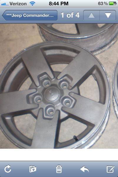

So being the poor factory working, sport driving, second baby on the way, my house costs too much type a dude that I am. I'm looking for a cheap way to satisfy my jeep needs (lift n 35's) till I pay it off and can get the good sheet.
So first of all it's my dd, I know someone will suggest it but I'm not going 33's, and it's a 2011 unlimited auto with 3.73s. I do go on trails but I mainly stay on the light stuff. When it's paid off and I get the goods I'll move on to the more challenging stuff. No hurry.

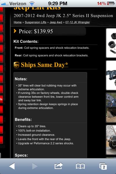

Well this is what I've found for a cheap setup and I was wondering if I'll need anything else or any suggestions for it. Thanks for your time.
Rough country 2.5 series 2 bb
Jeep commander alloy 17 x 7.5 wheels (to be painted)
Goodyear duratrac 315/70/17

With those wheels and tires you will need some wheel spacers.

I grabbed a 2.5 TF bb off craigslist for 250 brand new. You might consider scoping cl and the for sale section.

As for the original post. If you are on a budget, grab a 2.5" budget boost and add in a 1" bodyllift. This will give you plenty of clearance for 35s and won't cost much. I'm not a fan of wheel spacers. I've never seen one fail, but there is something about them I don't like. Grab a set of wheels with the correct offset. The smaller the diameter wheel the cheaper your tires will usually be.
