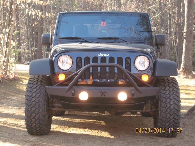

Old Feb 10, 2015 | 04:39 PM
jeepmojo's Avatar
Posts: 2,318
Likes: 12
From: New Hampshire
Default no lift here
ID:	59630533s your good to go . spacers even better but i did not and my mid bumper is heavy up front 130 no rub issues at all no sag , dont toss money at it till you know exactly what you want from it (my 2 cents ) i dont want a lift / dont need it i dont do the rubicon trail it looks like a hell of a good time though
ps. if your adding a winch you might want a 1/2 spacer up front ( budget boost good option )

Originally Posted by jeepmojo
<img src="https://www.jk-forum.com/forums/attachment.php?attachmentid=596305"/>33s your good to go . spacers even better but i did not and my mid bumper is heavy up front 130 no rub issues at all no sag , dont toss money at it till you know exactly what you want from it (my 2 cents ) i dont want a lift / dont need it i dont do the rubicon trail it looks like a hell of a good time though
Nice jk! Looks good
