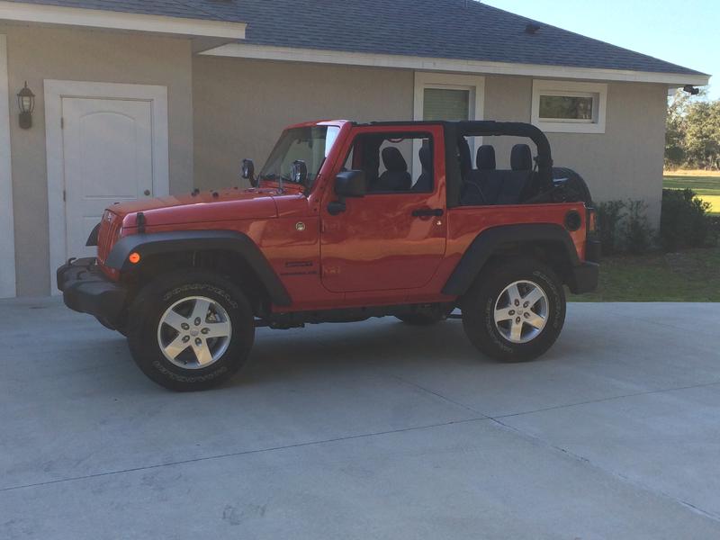

Hey all, I am a new jeep owner and want to give my ride a little lift and eventually get some 33's. I have been looking at the teraflex leveling kit, but i am worried that it will give me a negative rake. I tried measuring it, but i don't know where to measure, and can't seem to find any posts about this. I will attach a photo so you can see. Thank you.

With the Teraflex level kit you have options. It adds two one inch spacers in the front and 1" to the rear. It more flattens out the rake rather than adding negative rake. You're used to what you have, so it may "seem" that you're pointing to the sky, but you really aren't.

Positive/negative rake, or level stance, will depend on the specifics of 'your' jeep. Not someone elses. Any added weight to either end? Heavy bumper/winch up front. Bumper/carrier in back. Lots of tools in the back. Sagging coils at either end. Hard top or soft top. Kinda hard for us to do with a picture, you need to decide how much lift will work.

The Teraflex leveling kit raises the front two inches and the rear one inch. If you only install one spacer in the front you will end up lifting the front and rear one inch which will not level anything, but just sit one inch taller with the factory rake.
If you're unsure just simply install one inch spacers up front and be done with it.

Perfectly level will result in a squatty or saggy rear end if you load the Jeep with gear and people. Not exactly practical.

Exactly why the leveling kit doesn't make sense. The factory rake isn't an accident. The rake goes away when you have people and/or gear in the back. If you rarely have passengers or it's usually just one in the front - and you aren't hauling gear or adding new bumpers, then it works.

Yeah a squatty back end is exactly what I am trying to avoid. I don't have any bumpers or winch. It's a stock sport right now. Is there any other lifts similar that won't do that?

Any of the 2" Budget Boost spacer lifts should work, 2" pucks on all corners instead of the taller front/shorter rear pucks in a leveling kit.
