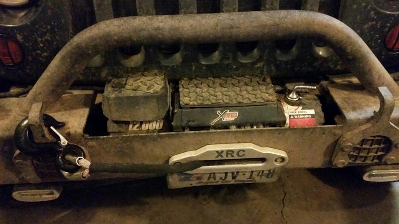

Pulled a 86 suburban out today... the XRC runs fast, smooth, quiet and has paid for itself in just a couple months. Two of the recovery's I did with it would have cost the owners more than the winch to get them out.
I made a cover using the optional "top mount" brackets for the control box.
The 12000 is completely hidden in the bumper on three sides, control box mounted to the left, and homemade cover over the line. Has helped to keep the snow and ice and mud from building up on the synthetic line. painted the front metal piece with color match paint to the Jeep (steel Blue) happy with the looks, the price, the performance, and the quality so far. Being water proof is a great bonus as well.

I'm interested in a picture of your cover that you made.

So the winch comes with the brackets to mount the control on top of -or to the side of the winch. I used a cutting block material plastic and a set of rubber treads found in the automotive section at wal-mart for 7 bucks to complete the look. The big smittybuilt name plate went away, the xrc came off the top control box and down in front on the color matched metal peice. Things are real muddy in this pic but you get the idea. The control bracket is hook shaped on one side and flat on the other... I bent them so they are very tight... but the cover can be pryed off and snapped back on if I need the drum exposed for any reason. Four bolts go throug hthe plate to the brackets... then I drilled holes for them in the tread so the hide down in the rubber tread. Worked great all winter for keeping most snow/ice off the line, and should keep sunlight off of it as well. Cheap cover... about 10 bucks! I also like the way the winch is hidden down int othis bumper.... very hard to get it out LOL!
