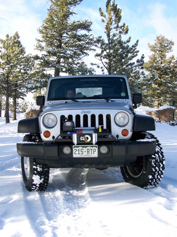

I wanted to do the same thing so I went with the Rough Country winch mount.
I have attached a picture of the completed product.
