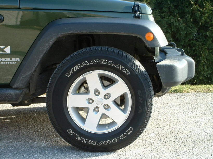

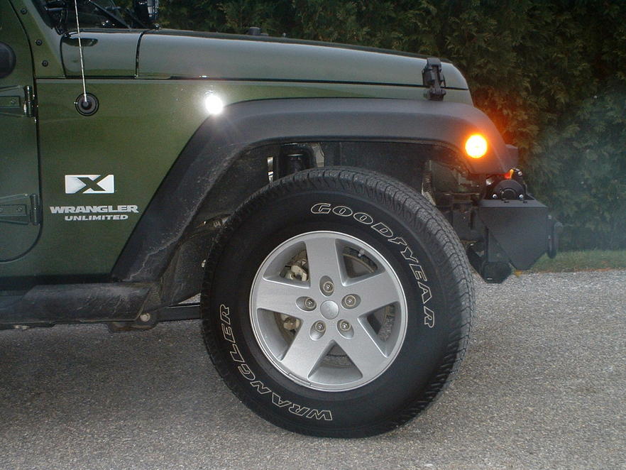

thanks everyone. i don't think i lost too much ride height. i snapped a couple pics of the before and after front suspension. maybe its all in my head...
