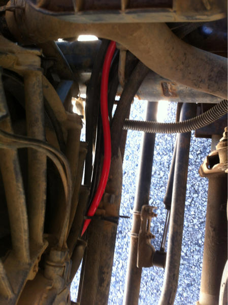

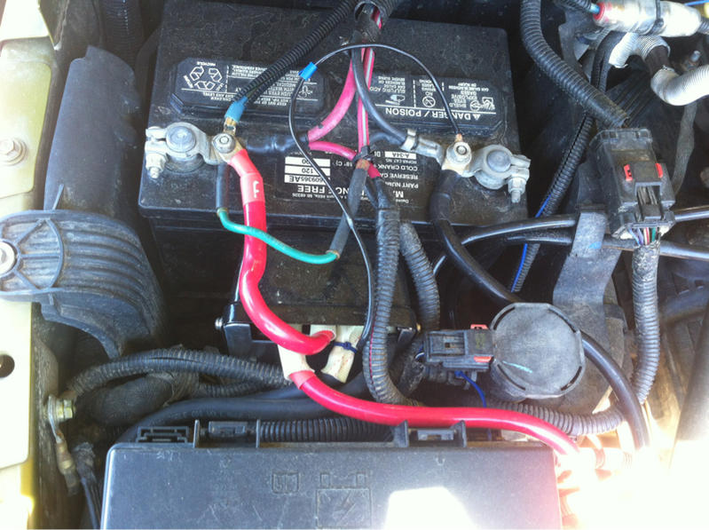

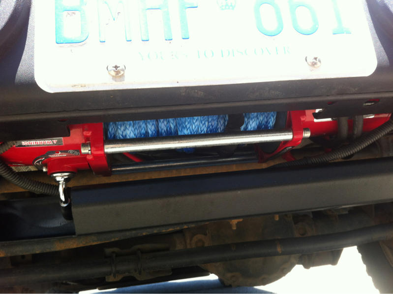

I installed my winch in the stock bumper and extended the lines to put the control box by the battery where it would be safe from water. I will be extending the wired remote into the cab but for now am using my wireless remote.
Attachment 464803
I would put some wire loom around that positive wire for safety's sake! Nice clean install.
Thanks for the heads up; I will be doing that today.

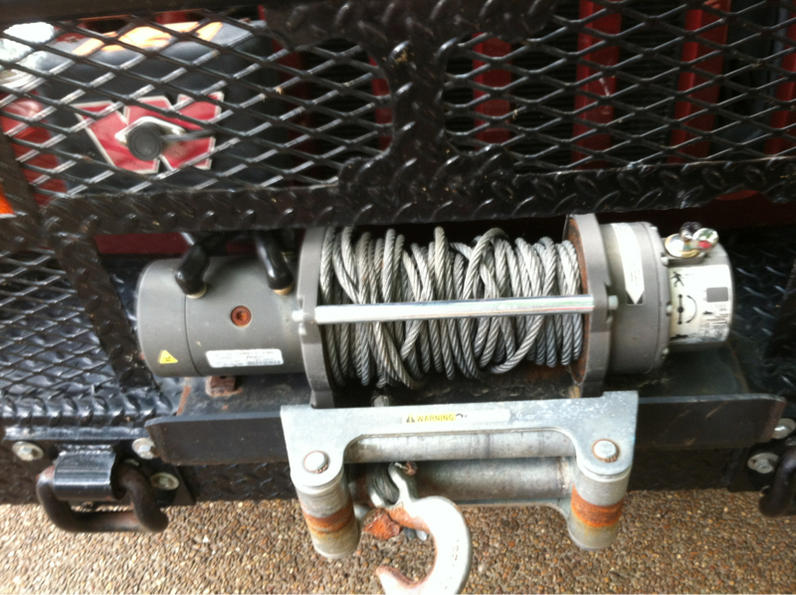

I bought the Recon 10,500lb wench. It is waterproof and comes with a wireless remote. No need to relocate the control box(part of the casing).
