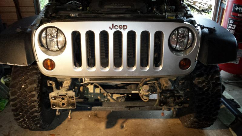

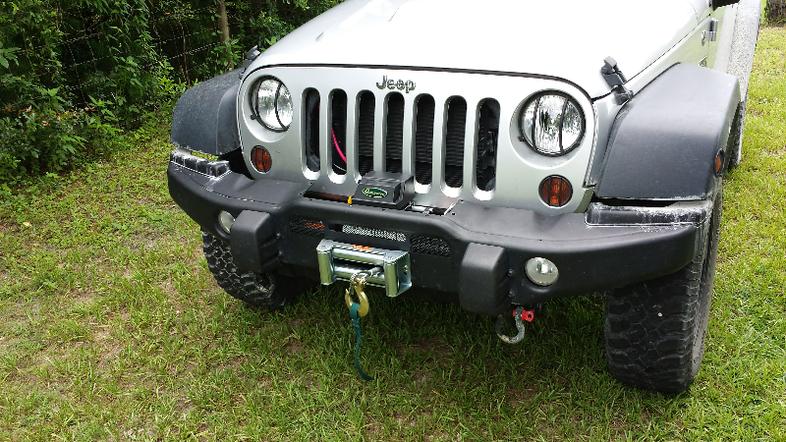

Old Aug 3, 2014 | 10:52 AM
slimpickins's Avatar
Posts: 64
From: Weeki Wachee, Fl
PM sent
ID:	569113   Click image for larger version

Old Aug 4, 2014 | 03:46 AM
Posts: 64
What crusader posted was the exact correct thing. That is what I ordered, just be careful of what winch you buy, not all fit in the bumper, nothing with internal solenoids will fit.
