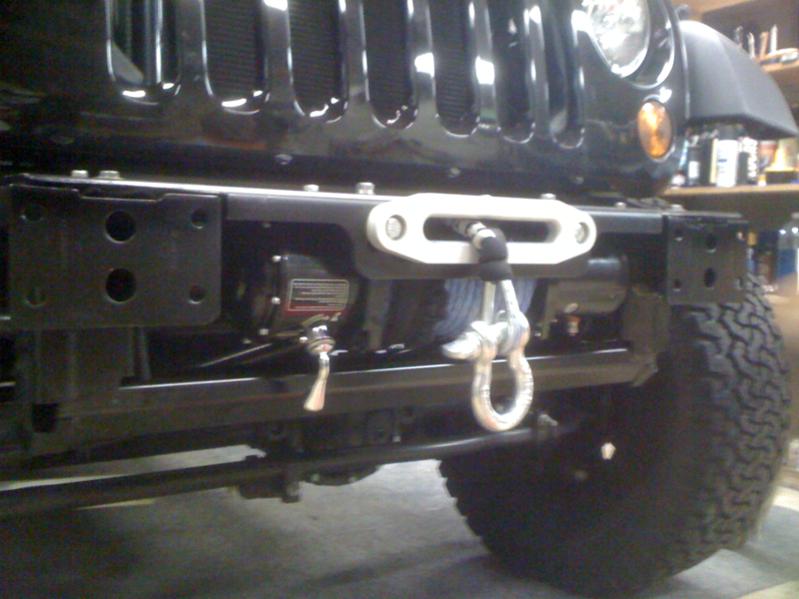

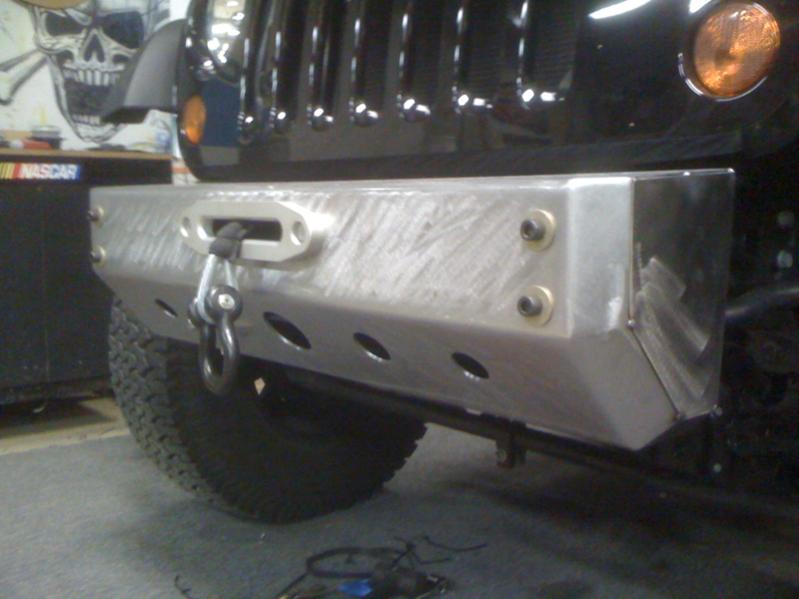

Matt, if you are building the bump. First mount winch where you want it, then build it around it... Getting numbers from other people will only make things confusing. Here is what I did.
I agree. Most winch bumpers are oversized to accommodate a wide variety of winches, many with integrated solenoids.
If you mount the winch and then build around it you will end up with the lowest profile, most integrated look... just like the excellent build pictured above
