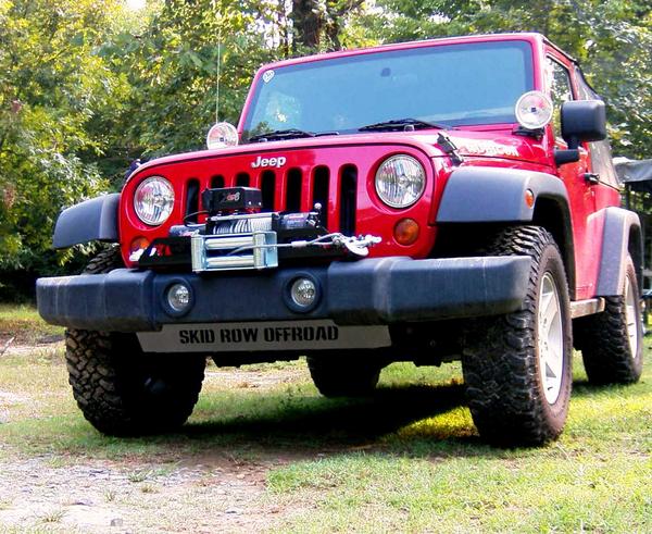

You could always hide it upside down inside the bumper like a member did to theirs. Then get the liscense plate mount for the rollers. When your on the trail just theow the lisence plate in the back and put it back on when you hit the road.
https://www.jk-forum.com/forums/show...t=hidden+winch

there is also a company that im not allowed to say here that makes a sweet plate so that you can set your winch up like the above pic

Originally Posted by BBirish
pm rnjstel ....
yeah it looks nice and all when its down in the bumper, but i did mine right ways up, cause think about it. if your winch is mounted upside down, that means your engage/disengage lever is under your bumper, and it means you cant see your drum when spooling cable in. but back to the lever. see how this jeep is going into some mud? what if the mud comes up to his bumper and he gets stuck? now he's gotta reach his arm down THROUGH the mud, under his bumper, to engage the gear. that's a little much for me. IMO
