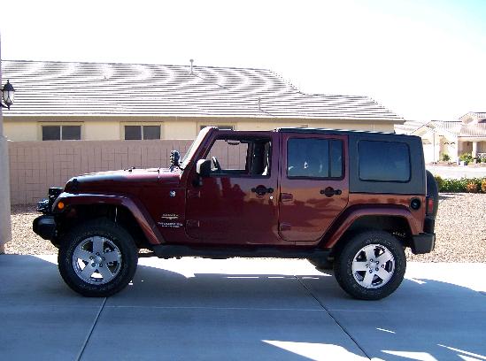

Here's how the Warn Winch plate goes on... This is what I used. It was fairly straight forward and didn't require cutting or drilling. It also has multiple attachment points on the front of the frame where the bumper attaches and on the each side of the frame. Very strong.
YOU WILL NEED AIR TOOLS.
