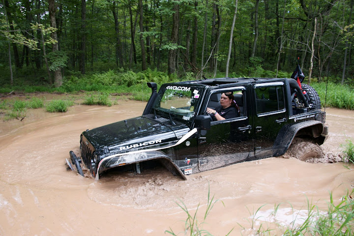

Our $300 Smittybilt XRC-8 has spent a good deal of it's off road life fully submerged and continues to rescue people when needed. Hasnt stopped working on us at all..... even worked when it was -4 degrees and a WARN Powerplant failed to work
Plus the snorkel was a great investment considering we've had this JK in mud/water holes that covered the flares completely!
