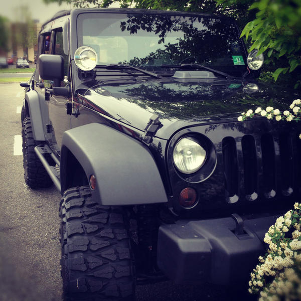

Here are mine Hellas love them

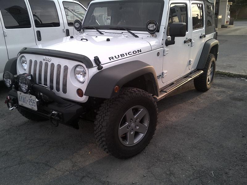

i have windshield brackets with a set of hella black magics. Boy are they bright !Click image for larger version
