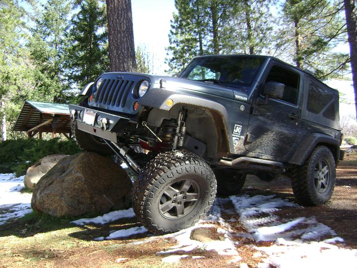

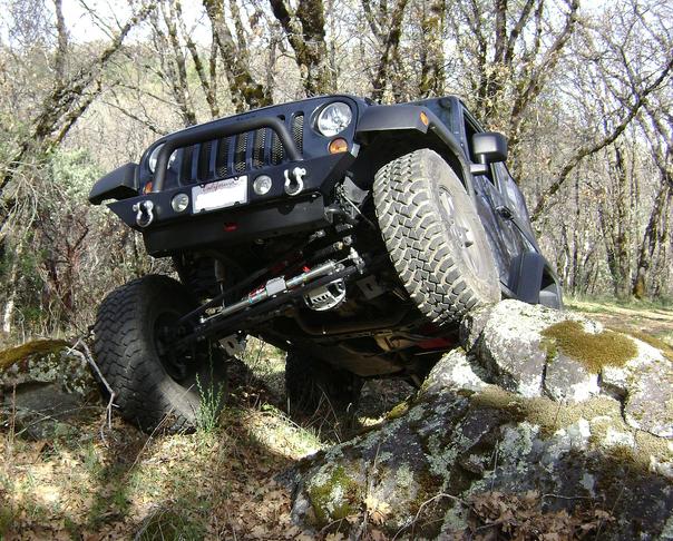

I'm really happy with the EVO 3" plush coils.

Thank ya. Tires are Hankook Dynapro Mt's (they're okay, I don't love them, but they're not a bad tire, just balance badly). I built my 3.75"-4" lift using: Evo coils, Fox 2.o RR shocks, Rock Krawler lower and rear upper control arms, Currie front upper arms, some JKS, Clayton, and Full Traction in there too.

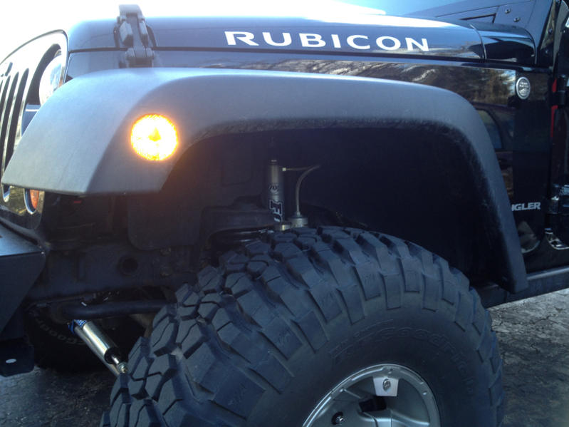

OP I am still considering a new coil. Ran TF's and now RK's.
I want the height of the RK's in 2.5
EVO's or MC's 3.5's are my choices. AEV is they sold separate.
- teraflex/fox shocks
- synergy steering
- 35x15 KM2

They perform great. Nice ride, smooth flex. They yield a bit over 3" of lift. I have 1/2" spacer on front, 1" on rear. Running 6" lift fox remote res shocks, I have lots of travel. Nice coils
