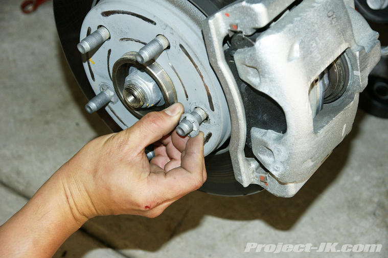

I just added 1.5" wheel spacers and at 55mph i have some slight wobble.. i havent aligned yet.. i just wondering if anyone else with spacers had this problem..

Did you take the little keeper washers off the factory studs?

no i didnt.. is that able to come off?

You need to take those off , they will cause the spacer to not sit flush on the hub.hence, wobble

http://project-jk.com/jeep-jk-write-...ation-write-up

thanks guys... jerked those old things off and smooth ride ahead..
