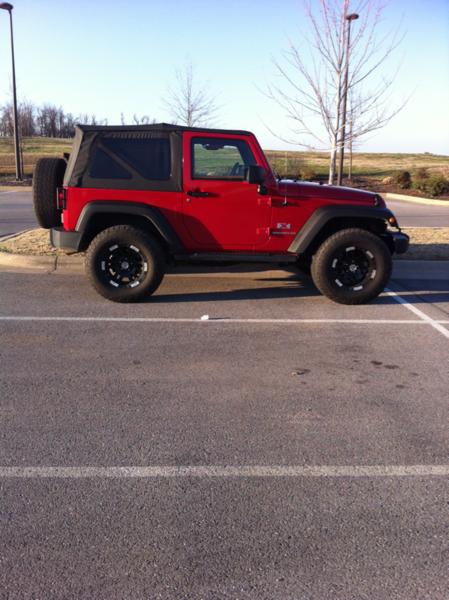

Hey guys...My 2008 X is currently running a Skyjacker 2" BB with spacers and 7000 series hydros, but I feel the front end is sitting to low and I'd like to raise it up a little to make it look more level. I'm interested in aftermarket bumpers but I think the jeep would look even more raked. What's everyones opinion? Are there any problems with the front end being raised? What are my options or are there any besides a different lift? Maybe it's just me...

To my knowledge I just have the coil spring spacers front and rear. I thought the spacer kit was the budget boost.

Is the stock isolator still on the front? If not, that could add to your rake.
I'm not sure I'd add another spacer to the front to level this.. maybe drop down to a 1" spacer for the rear?

I'm 37 1/8 to the front lip and 37 5/8 to the rear lip...sounds like about 1/2 inch to me
where is that located and how can I check that? Also I really don't want to lower the rear any...I like the height.
