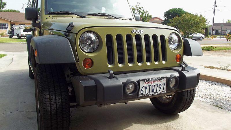

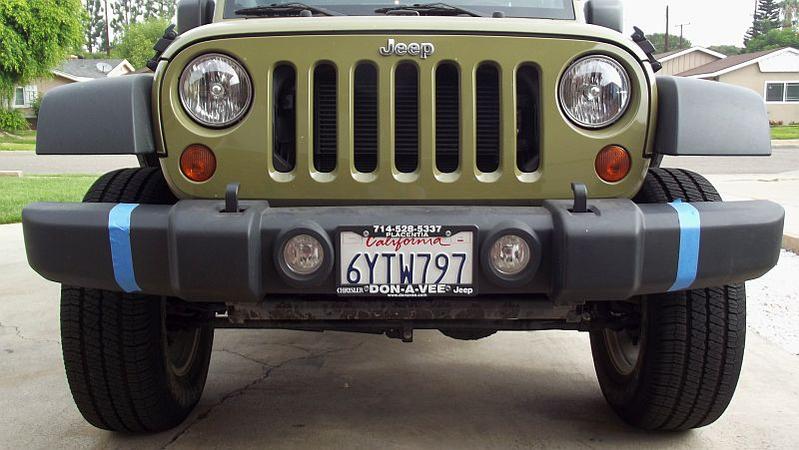

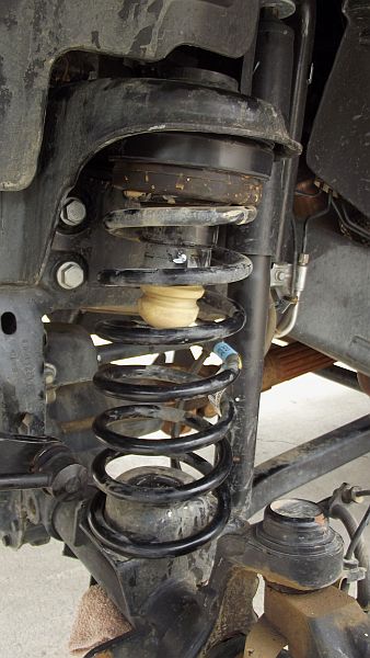

Old Aug 21, 2013 | 05:35 PM
groovebus's Avatar
Joined: Apr 2013
Posts: 122
From: Anaheim, ca
OK, here it is the Teraflex 2" leveling kit and Rough Country Stubby Bumper Mod.
ID:	490420   Click image for larger version
ID:	490421   Click image for larger version
ID:	490422   Click image for larger version
ID:	490423   Click image for larger version

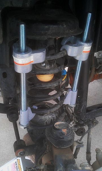

Old Aug 21, 2013 | 05:40 PM
groovebus's Avatar
Joined: Apr 2013
Posts: 122
From: Anaheim, ca
Forgot the during shots.
ID:	490425   Click image for larger version
