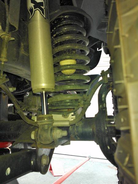

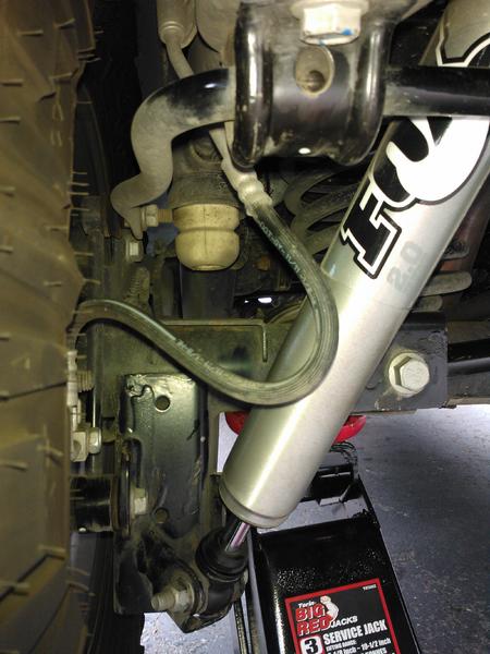

Unfortunately, my jack was not tall enough to do the trick. With that said, it was tall enough to at least show me that my suspicions were correct. There is more travel to hit the bumpstop than there is to hit the bottom of the shocks (front and rear below respectively).
Anyone have any ideas what I can do to resolve this issue?
Old Aug 6, 2012 | 11:18 AM
JKbender's Avatar
Posts: 684
From: Chicago, IL
To keep these shocks you would have to go with longer bumpstops. However, I would call the shop that you purchased them from and ask for replacments in the correct length. If you ordered stock length shocks then it is there falt. If they tell you that the purchase was too long ago then point out that you just learned of their f-up because of the big bang sound when they bottomed out.
