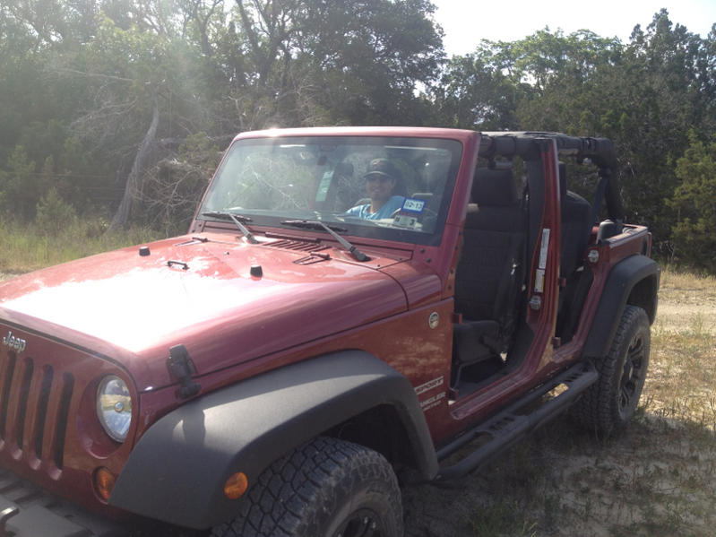

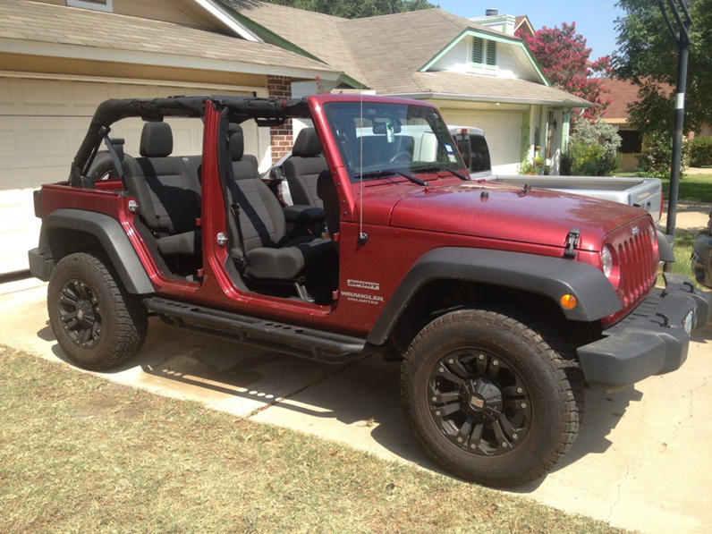

I just upgraded from my 18" XD monsters, they were +18 offset with 275/70 terra grapplers. Stayed flush inside the fenders like you want.
Aaaaand i have to shamelessly plug as they are still for sale btw.

thanks for the pic, thats about how I pictured them based on the math. Free bump for your wheels and tires too
