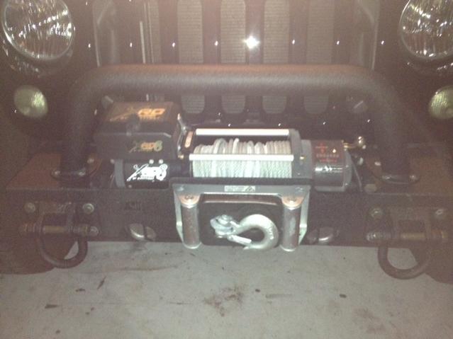

Here is mine: The wires are actually pinched up against the grille.

I'm not sure what I coulda done wrong...it took some real manipulating to get the bottom tabs in for the grille...just no room.

That looks similar to what happened to me the first time.
What I did:
It'll be a pain in the ass but you will have to unbolt the winch and feed the wires through first. BE VERY CAREFUL with one of the skinnier black wire (i think it's black...located in the bottom of the winch), I ripped mine off when I had to re-do it.
I don't remember, but you might even have to take the bumper off as well, feed wires though before tightening all bolts.
2nd option:
run the wires though the slots of the grill.
It took me 3 tries before I was satisfied.
Also:
If planning to run a hoop over rider, you will need to move the solenoid to the left and fabricate some sort of bracket to tilt it a few degrees so the remote will fit.
I will try to take photos and see if I can help you out.
