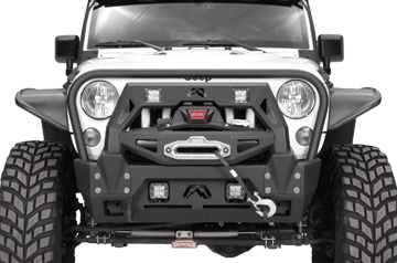

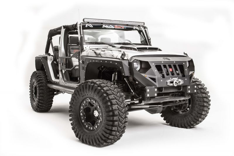

ID:	647489Click image for larger version
Air flow? What is that?
