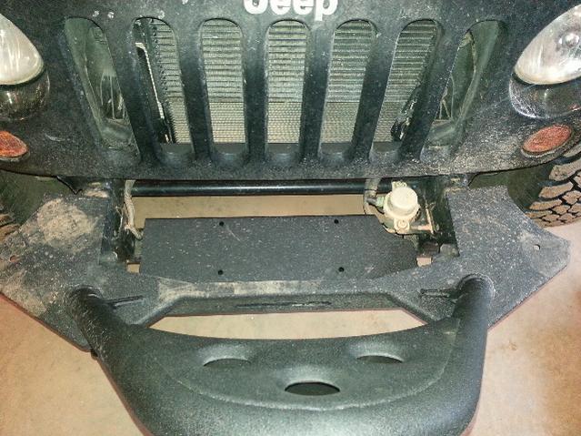

Old Jan 29, 2013 | 11:45 AM
jireson's Avatar
Posts: 16
From: Charlottetown, PEI
don't know if this will help you much but this is how the inside of my Smittybilt SRC Stinger Bumper looks.
