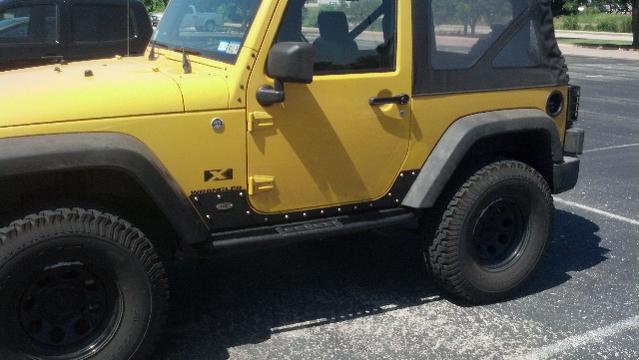

Here a photo of how it ended up. I combined the XRC side armor with the SRC rock rails that have a step on them.

You know most of the side armour is mounted that way so it doesn't matter what company you buy from. The majority of body arm is held on by screws & nut certs
Only way would've been to get armour through "trailskinz.com" His go on with marine adhesive.

Well at least all the hard work was worth it, turned out good!
