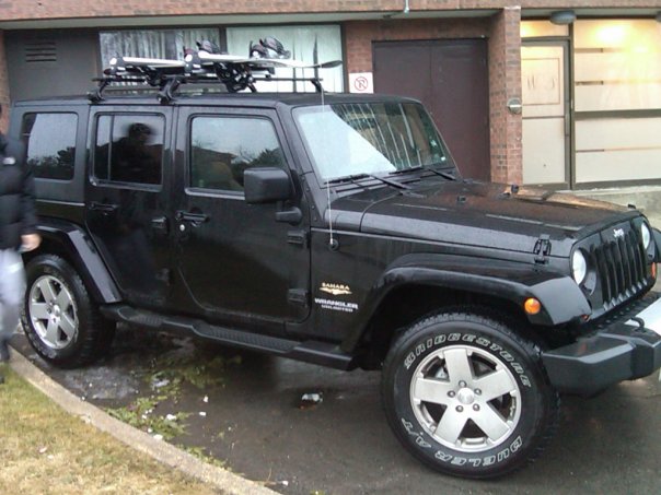

my setup was very simple and easy to install. i purchased the thule rain gutters and 50'load bars off of craigslist for $50 and i got the Thule 925 roof rack for another $100.
the setup took about 20 minutes to install without any instructions. i wouldn't put the gutters on the freedom panels as it puts to much stress on it. i secured mine to the rear of the hard top.
check mine out. i still need to buy a fairing to reduce wind noise and drag. i drive about 150 km's to get to the hills and worked fine.

So I went with rain gutter mounts with the 2 door. Both sets are sitting on the fron freedom panel. It has been working very for last two months. I've even done a four hour high way round trip with two snowboards sitting on the rack. The only problem is the wind noise.
It has been working well.
