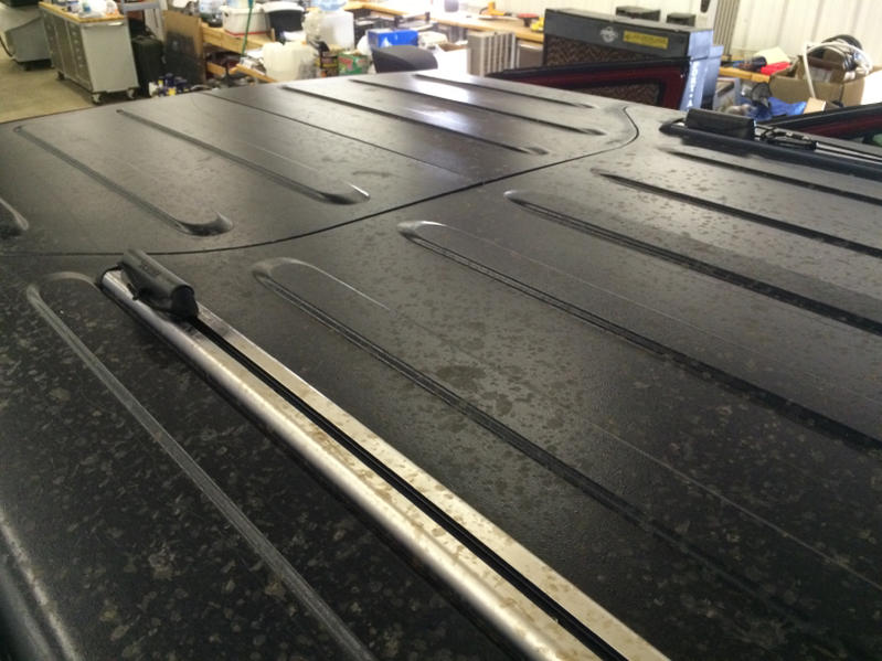

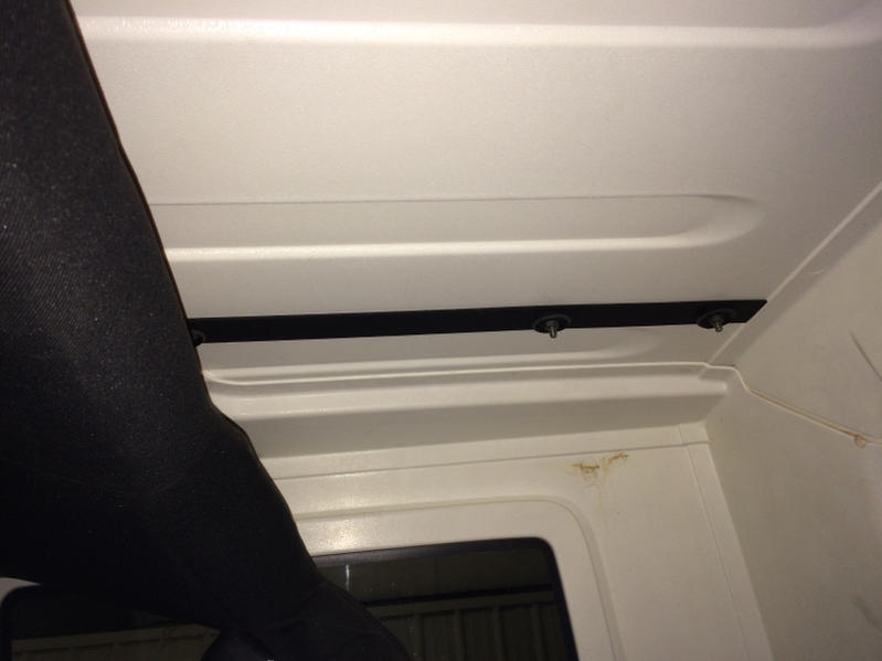

I drilled Yakima tracks in my hardtop as well. On the inside of the roof, however, I put some thin steel plate between the roof and the nut to better distribute the load ( I was afraid the bolts may crack the roof). I've only used mine to transport paddle boards but so far so good! Click image for larger version

Can either rack support one or two 40lb kayaks? That is why I am a little leary of the rain gutter mounts.

1 shouldn't be a problem. I'd be cautious with 80lbs up there. Probably be fine, but it might not be. The closer to the edge of the roof the tracks are the more weight it will be able to hold. In a static situation (driveway test) it will be fine. It is when the jeep is moving and the bounciness of the road that I could see a problem. You also have wind from your speed which is putting additional forces onto the roof.
