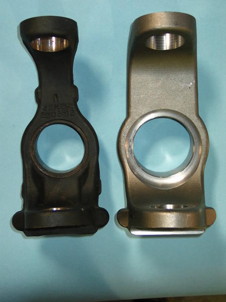

If you check the pic below you'll see that there isn't a way to get an accurate measurement off of the end forging itself. If you could check a stock rig at the same area of the 'C', you could compare the measurements. Let's say your measurement is 6* and the stock rig measures 8*. Since we know that a stock rig has 4* of caster we could conclude that you have 2*. Does this make sense?
Attachment 186894
yes, i understand what you are saying. Can you tell anything by the pictures below?

Nothing glaring.
I'd get the front end up on jack stands and turn both front tires at the same time, by hand, and see if you can duplicate the noise. Your video shows the noise at very low speeds so you may be able to find it by hand.
While the tires are off the ground you'll also be able to check the hub bearings (aka unit bearing). Is your camber visibly off?
