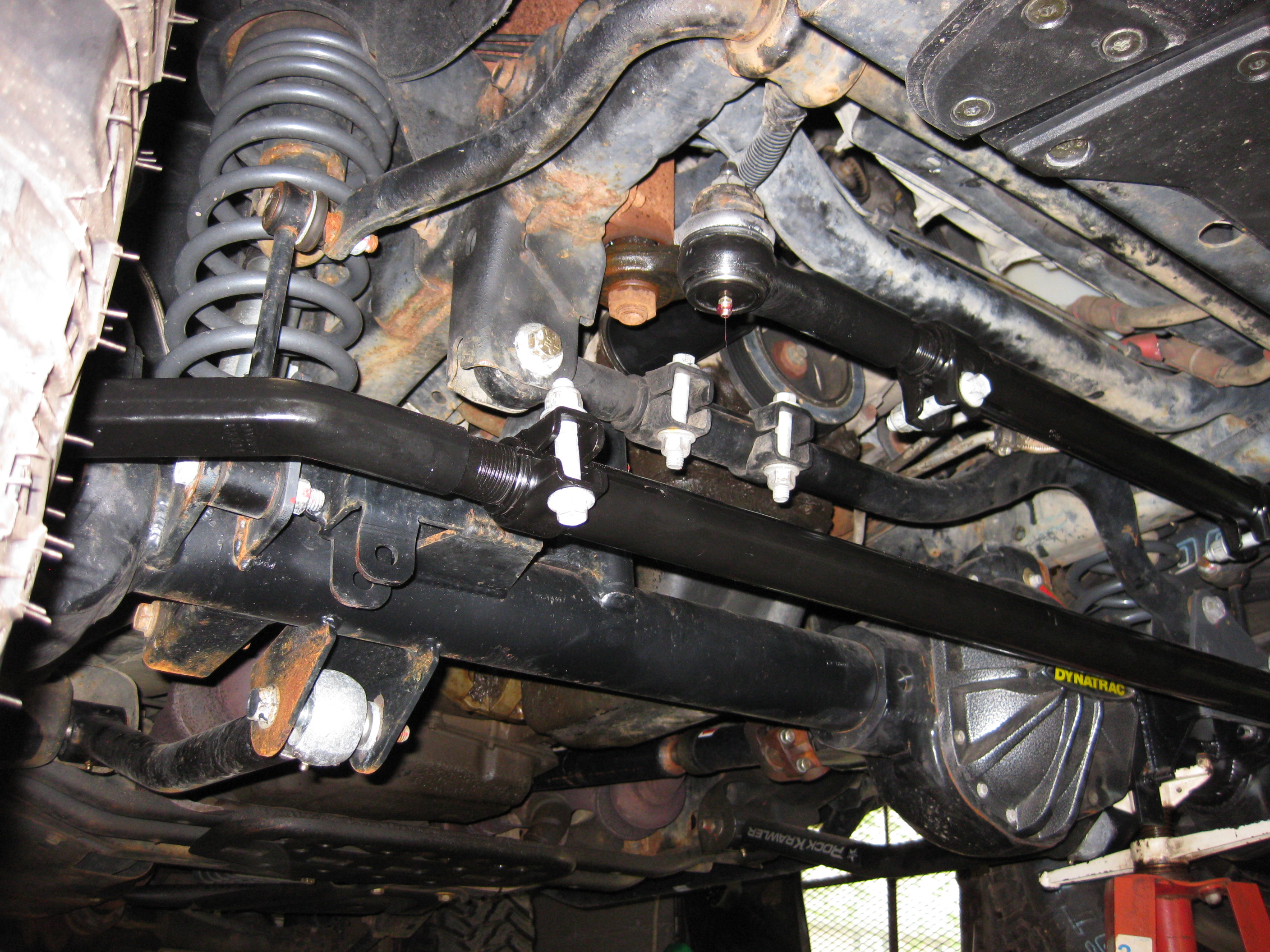

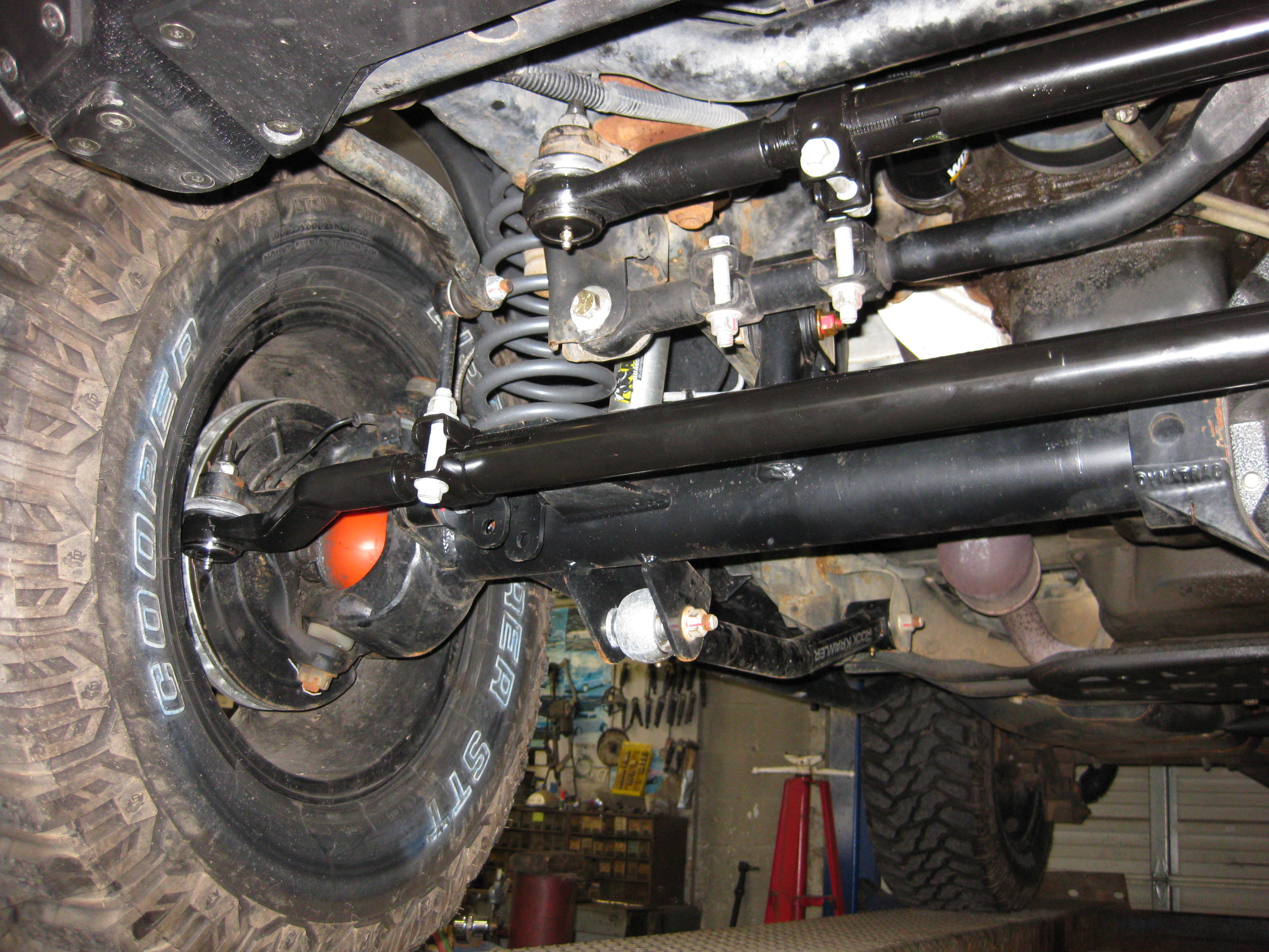

The Yeti linkage by Steer Smarts is available for right hand drive now.
Replaced the Synergy tie rod and drag link with the no drill high steer Yeti drag link and tie rod.
Amazing ! No more bump steer, steering is perfect now. This is a huge improvement.
It's been available for left hand drive for a while, the right hand drive version was just added.

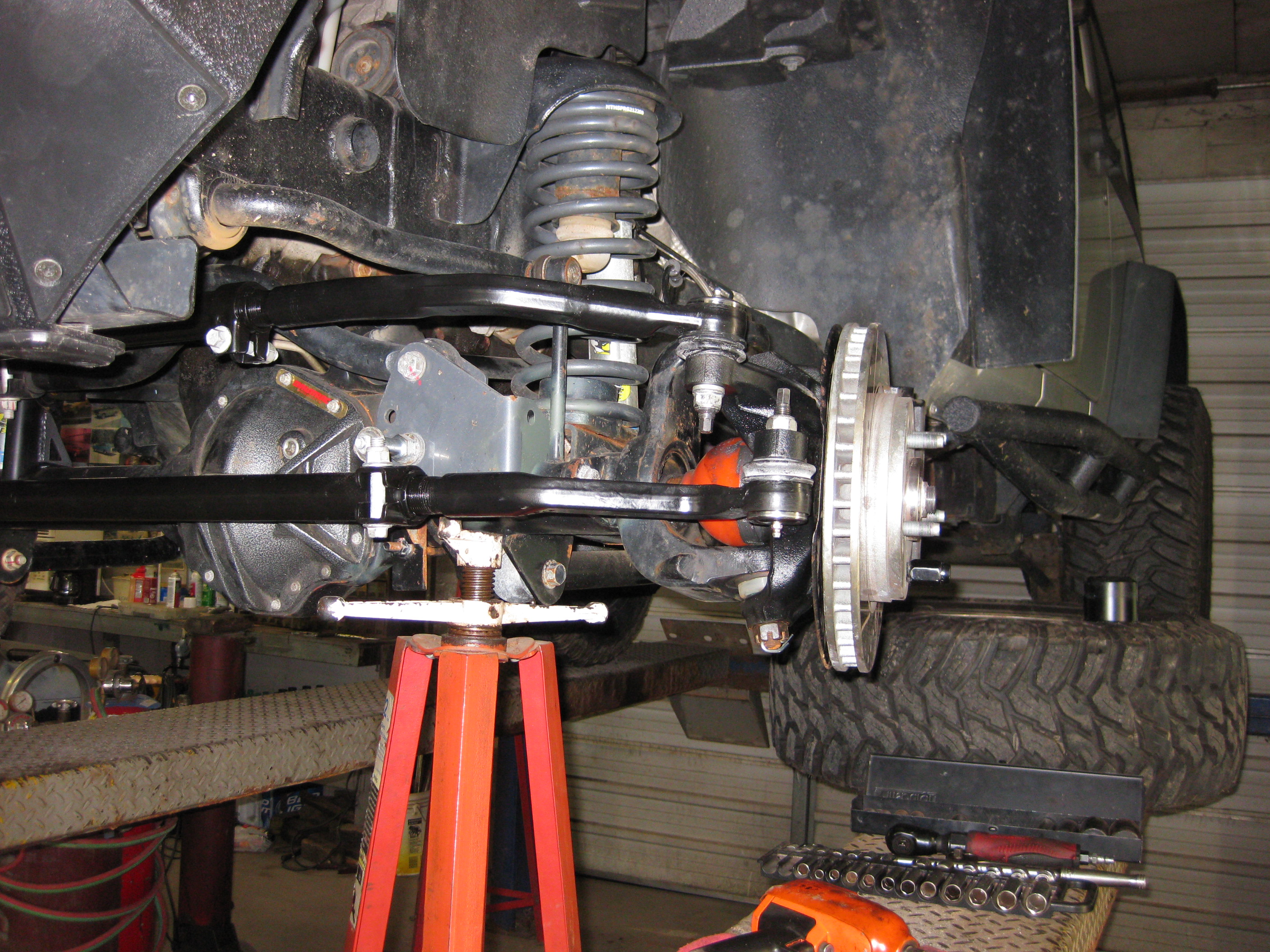

Do you know that your lower control arms are upside down?

LOL, good catch. I like the yeti kit, looks really beefy.
Was going to point out the same thing!!
Good catch .. Totally missed that. You should be able to swap left to right without a issue.

Wow, I did not catch that either. Just one more screw up by the shop that done the work. It's becoming a pretty long list.
Thanks for pointing it out guys.

No prob. I think you will be much happier when they are swapped. You are probably hanging them up on everything. Nice high steer by the way

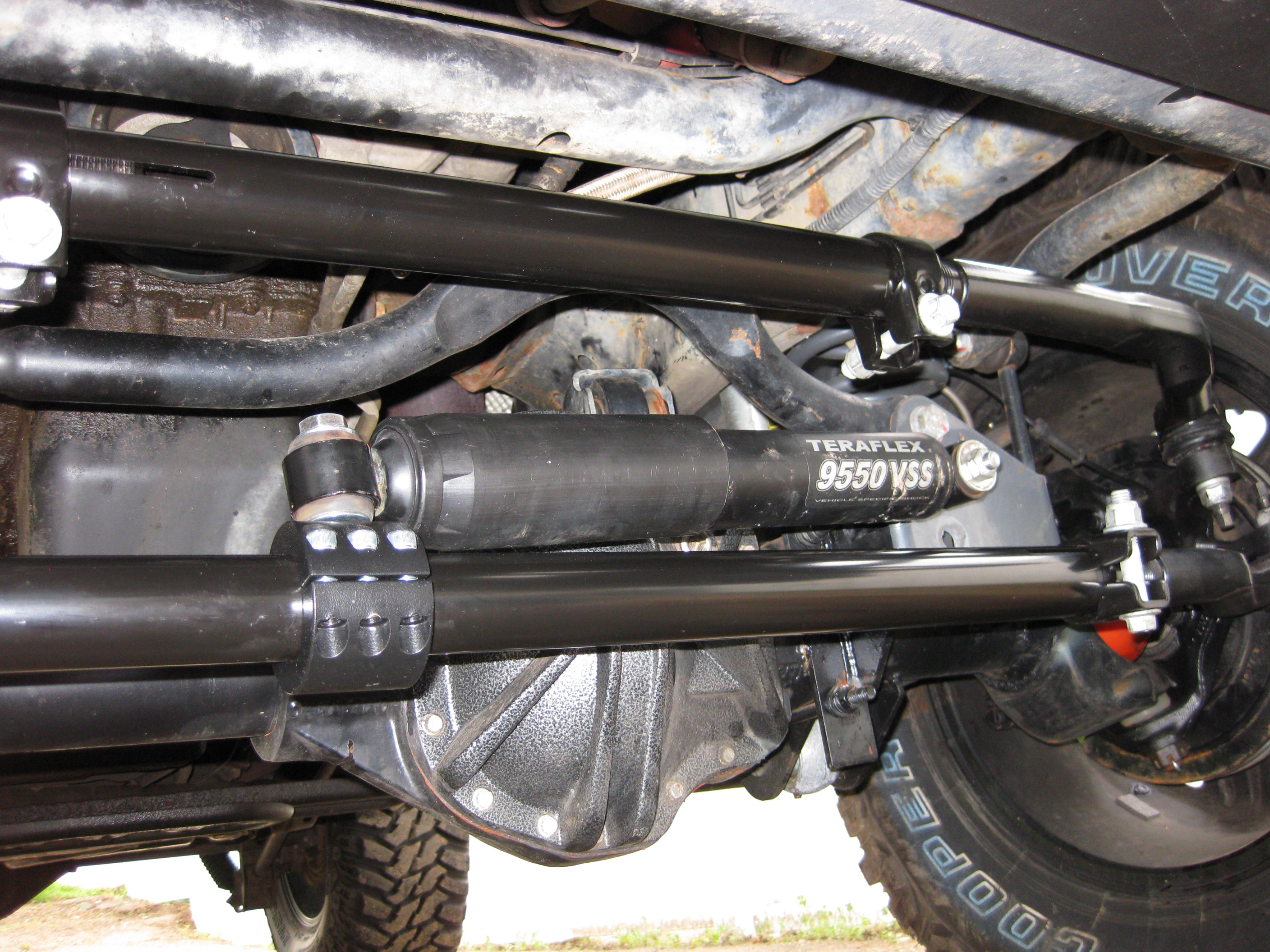

Originally Posted by rhjeepdriver
Extreme heavy duty linkage ! The pictures just don't do it justice.
No they don't. Even the forged rod ends are massive, sealed better than any joint ive seen. And Because of the no flop feature the joints should last for a very long time.
