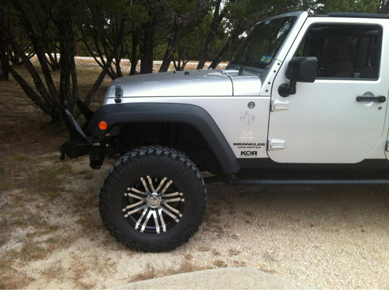

I have 33s with a 4 in lift kit for a JKU. No drive shaft needed. No spacers either.

Here is a side shot
You have aftermarket rims and therefore dont need spacers. He wants to run stock rims. So to the OP you will need wheel spacers.
Here is a side shot
The OP has stock rims so he will need spacers. He also has a 2012 which will likely require a new front drive shaft with a 3" lift. I'd go with a smaller lift or leveling kit with 33s.
