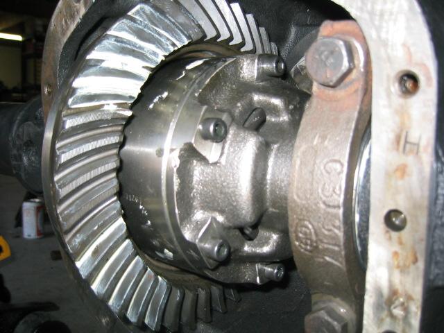

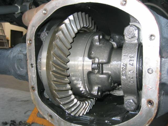

Looks like a Yukon D30 JK part number? You're good to go.
The front axles are high pinion, 'reverse rotation'. So gears that specify reverse are what you want.
These aren't for a JK, but they show the difference in the way the gears rotate.
