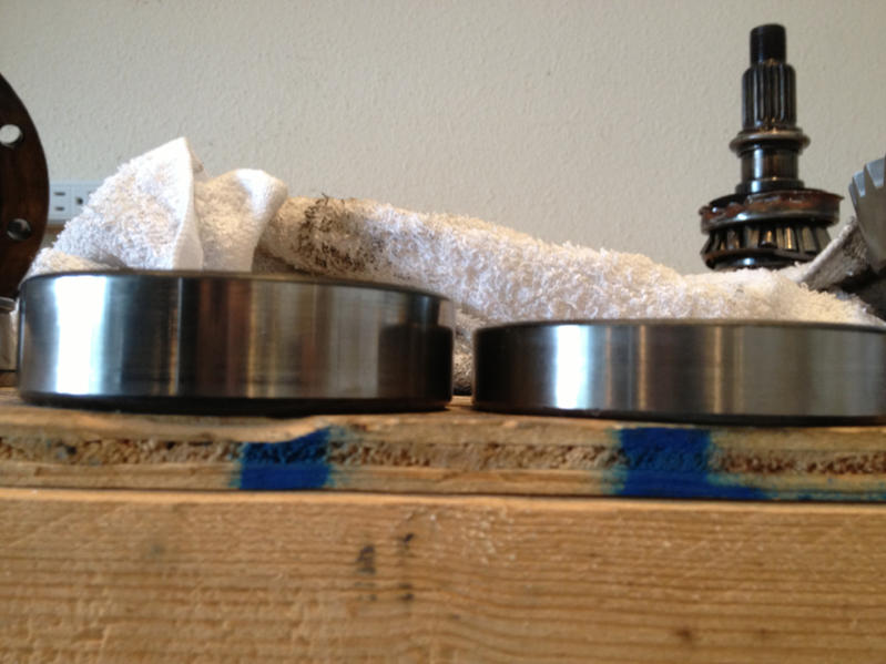

I think I figured out the issue but don't know why or if it is supposed to be like this. The housing bearings and races that came with the zip locker are significantly thinner than what was on the stock carrier. Because of this it is requiring significantly more shims to get the carrier to not have any play left to right. Like I mentioned I used every shim that came with the zip locker including the master shims and it still doesn't fit tight into the housing. I'll attach a pic of the new race compared to the stock race.
