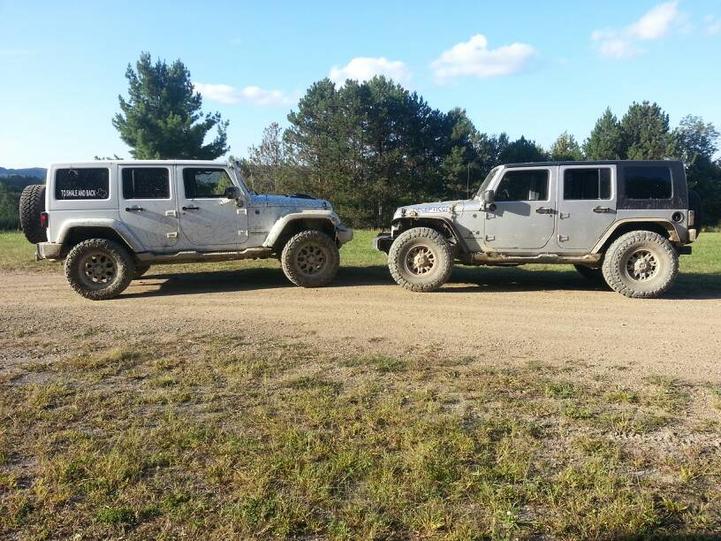

I do have a friend running the 4" zone kit on 35's. I have a picture of it in front of my jk with stock lift on 37's. He's not pulling much height on me. His is the white on the left, mine the silver on the right. This was before he added his aftermarket steel bumper too.
Not a 3" but I would have expect more height from a 4". It does look good on his white Jeep though.
Sent from my SM-N900P using Tapatalk
