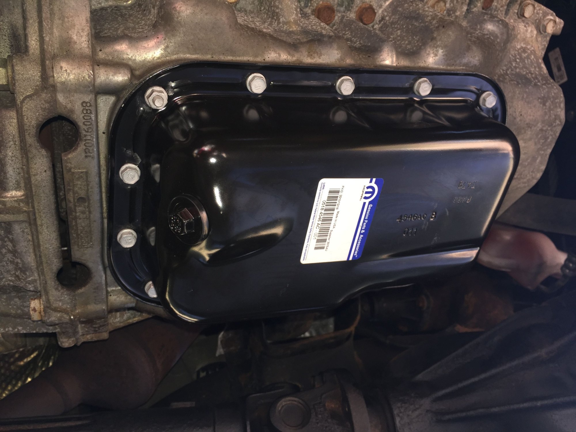

Default New lower pan
One of the bolts appeared potentially dangerous, but
my dad and I finished the job. We elected to use a gasket instead of the RTV sealant.
Old Mar 9, 2020 | 11:29 AM
resharp001's Avatar
Loved
Community Favorite
Joined: Jun 2013
Posts: 11,357
Likes: 2,088
From: Willow Park, TX
that looks exponentially better!
Old Mar 10, 2020 | 03:42 AM
Ghost JK's Avatar
5 Year Member
Joined: Dec 2016
Posts: 269
Likes: 53
From: Florida
Big difference. Nice job.
